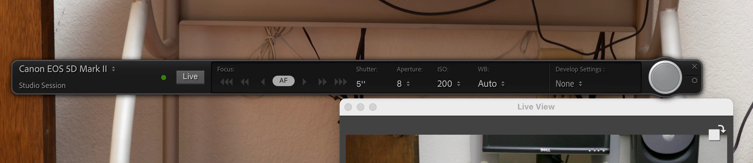

My Canon 5DMk2 tethers fine using LrC 11.3.1 and MacOS 12.4 with the cable that came with the camera.
M4 Pro Mac Mini. 48GB
