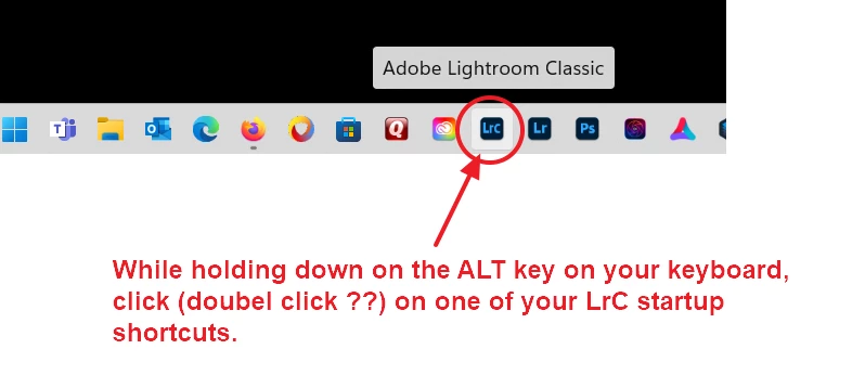

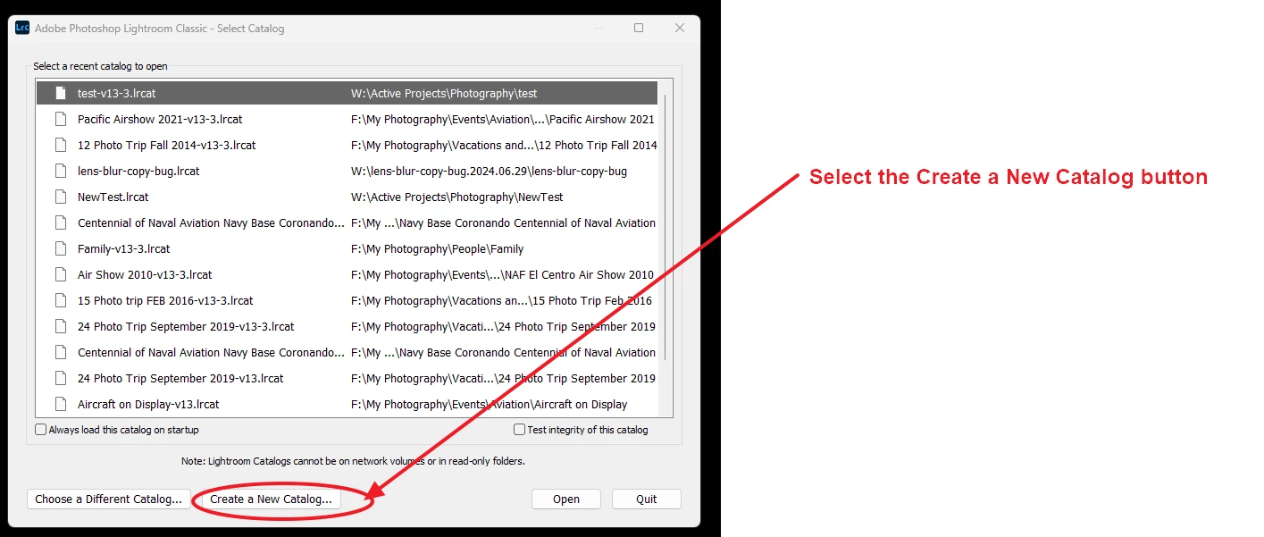

2. Starting a new catalog. To see if perhaps your catalog is corrupt. So corrupt that you do not get an error message. While holding down on the ALT key on your keyboard, click or double click on one of your LrC startup icons. This should bring up a LrC prompt asking you to select a catalog. In this case, select the button "Create a New Catalog"

This did it. Thank you so much.

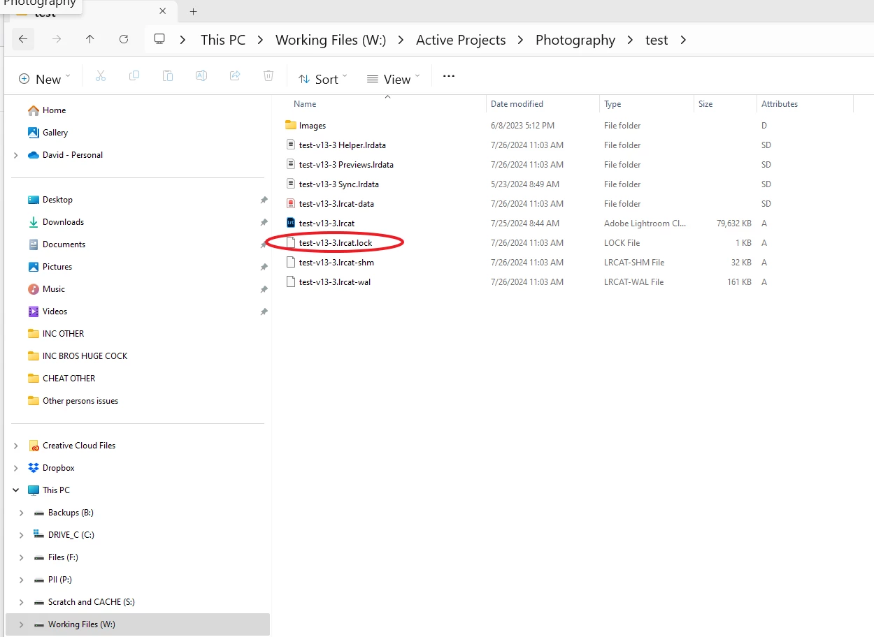

Using Windows File Explorer, bring up the folder your catalog is in, and see if a lock file exists. This lock file should only get created upon LrC start, and deleted upon LrC close. It will not get deleted if LrC crashes, or you force quit LrC. It exists to prevent more than one instance of a catalog being open on a computer at one time. You should get a error message if it exists, but...
