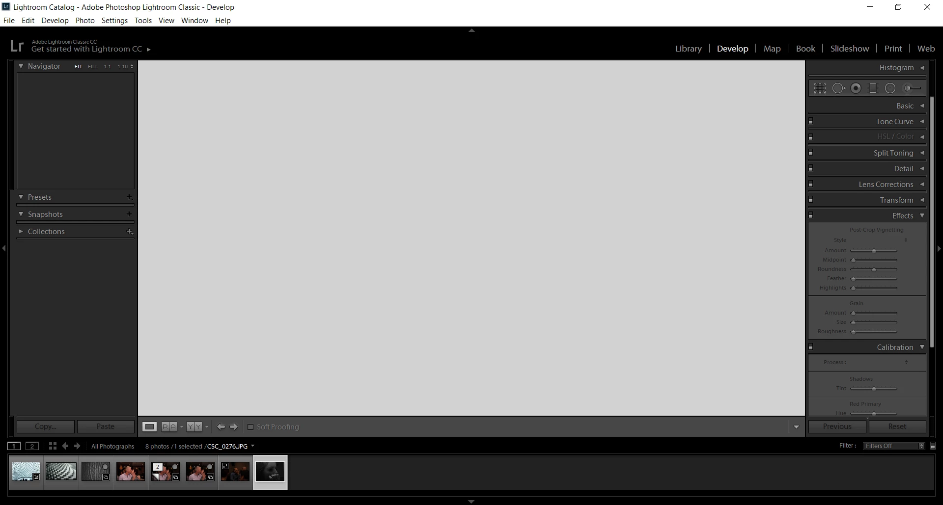

Lightroom developer mode does not work at all.
I tried to work with lightroom developer mode but when I select an image it still stays on the grey screen instead of showing the image I want to work on. I tried disabling my gpu but this did not change anything at all so I re enabled them again. I am trying to figure out what the problem is but all I can figure out is that maybe it is because I started the trial first to see how it works.

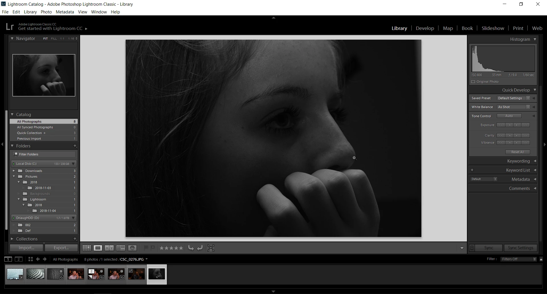

I have the exact same problem. I also tried adding the config.lua file, updating GPU drivers, changing the monitor profile, different file formats and much more.
Selecting the picture in Library:
View in Develop:
