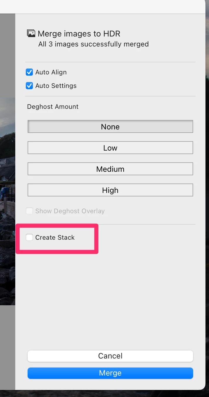

So how do you stop LR from stacking the HDR file with the Source file?
Jim Wilde
July 6, 2023
Uncheck the "Create Stack" option in the HDR Merge dialog box:
