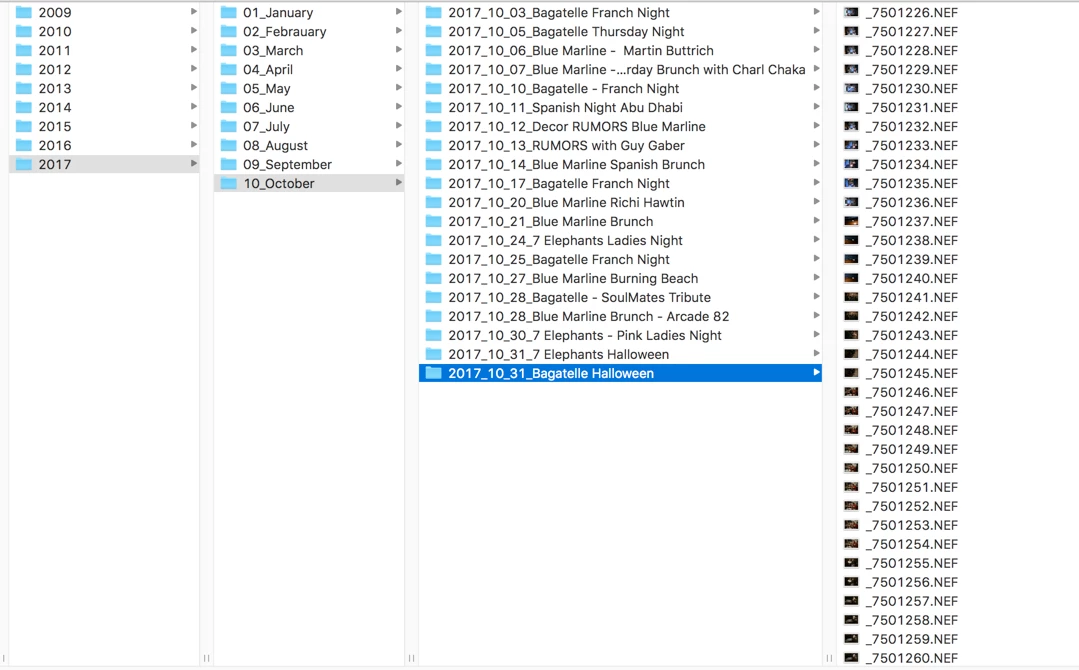

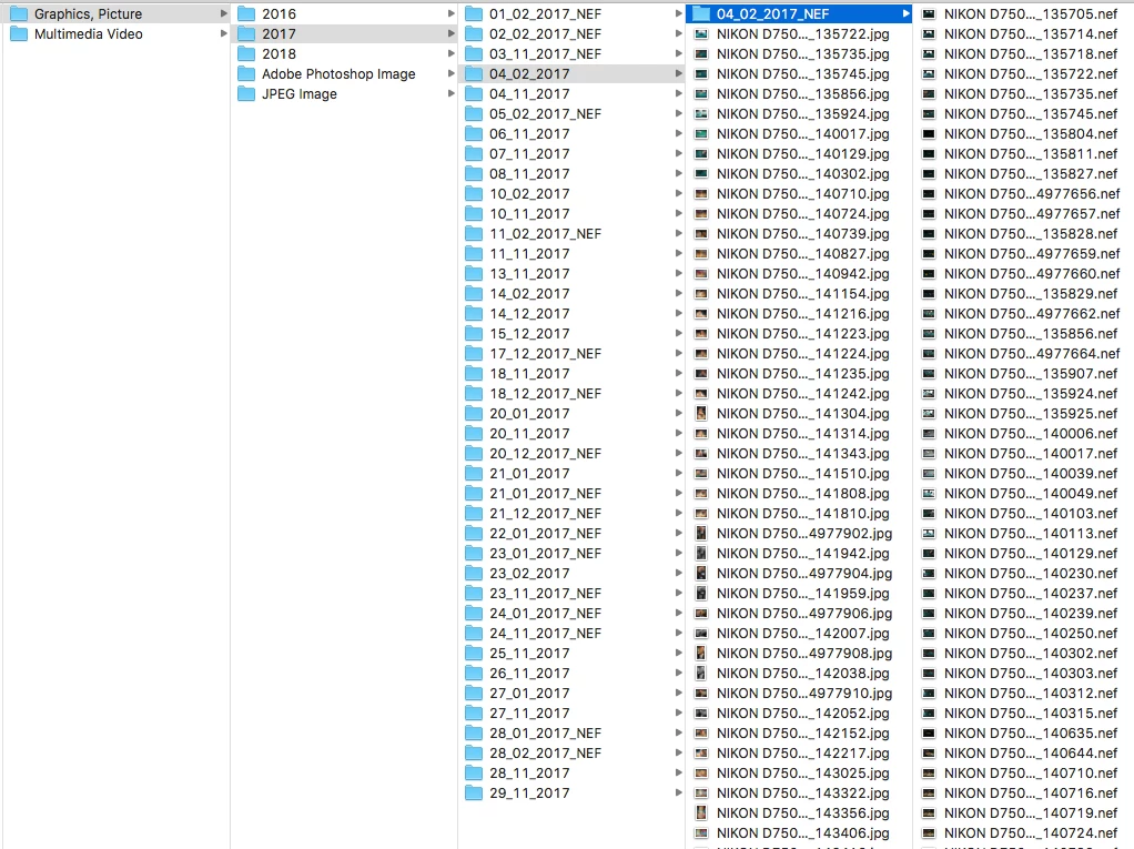

They still didn't rescue but they send me a few screenshots of how it looks like
This is rescue files
and this is how I have before
Folder structure (second picture) I all ready export from Lightroom Library and yes I get an error message that the original could not be found but I get at least folder structure so I can sort back rescue pictures. Questions are how then I can change the files name of each image so I can link back.

You should wait till you have the images back and then compare them. These screenshots say very little, because different folders have been selected in both screenshots. It looks like maybe the rescued picture has a file name that is the same as the original file name, but the camera name added to it. That is something that can easily be stripped again by some renaming utility. It also looks like they have rescued the embedded jpeg previews separately, which you could simply ignore.
