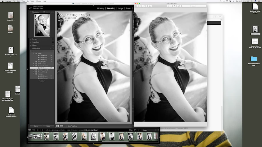

Hmm, that looks weird to be honest. I would not expect sRGB in the name of a calibration profile and the size of the profile is too small to be a real calibration as that is not enough to have any calibration tables in it. This looks therefore like it is not calibrated and it probably is just a sRGB profile. Generally Macs, including iMacs have a profile called  "Color LCD" as their default that should be a bit better than a plain sRGB profile. If the control panel in System preferences->Displays->Color has the option "Color LCD" in it for profile, try that and see if it makes a difference for the changing of contrast.  What you need to do after that is to get yourself a calibration puck that actually measures and corrects your display. They are not that expensive but are essential if you want good results from doing digital photography as otherwise you can't trust what you see. There are several brands such as the Spyder Pro's, the ColorMunki, the i1 displays and others. Another alternative if you son't want to spend the $150 or so for a good entry level one is to see if one of your local camera clubs has one that they borrow out to members. You can also rent them from lensrentals.com and such.

Okay, so it looks like I have a follow-up question to this same problem, if you can help me. I just compared a few of my latest exported photos with what I see in Lightroom, and they are definitely still different! The contrast and clarity specifically are what I'm seeing change. I'm at a loss for what to do to fix it!
Jan 7, 2017 6:56 PM UTC
Ah. Yeah her eyes look somewhat darker on the left and her hair is darker there too. That looks like a calibration issue to be honest. How  are you calibrating your display?
