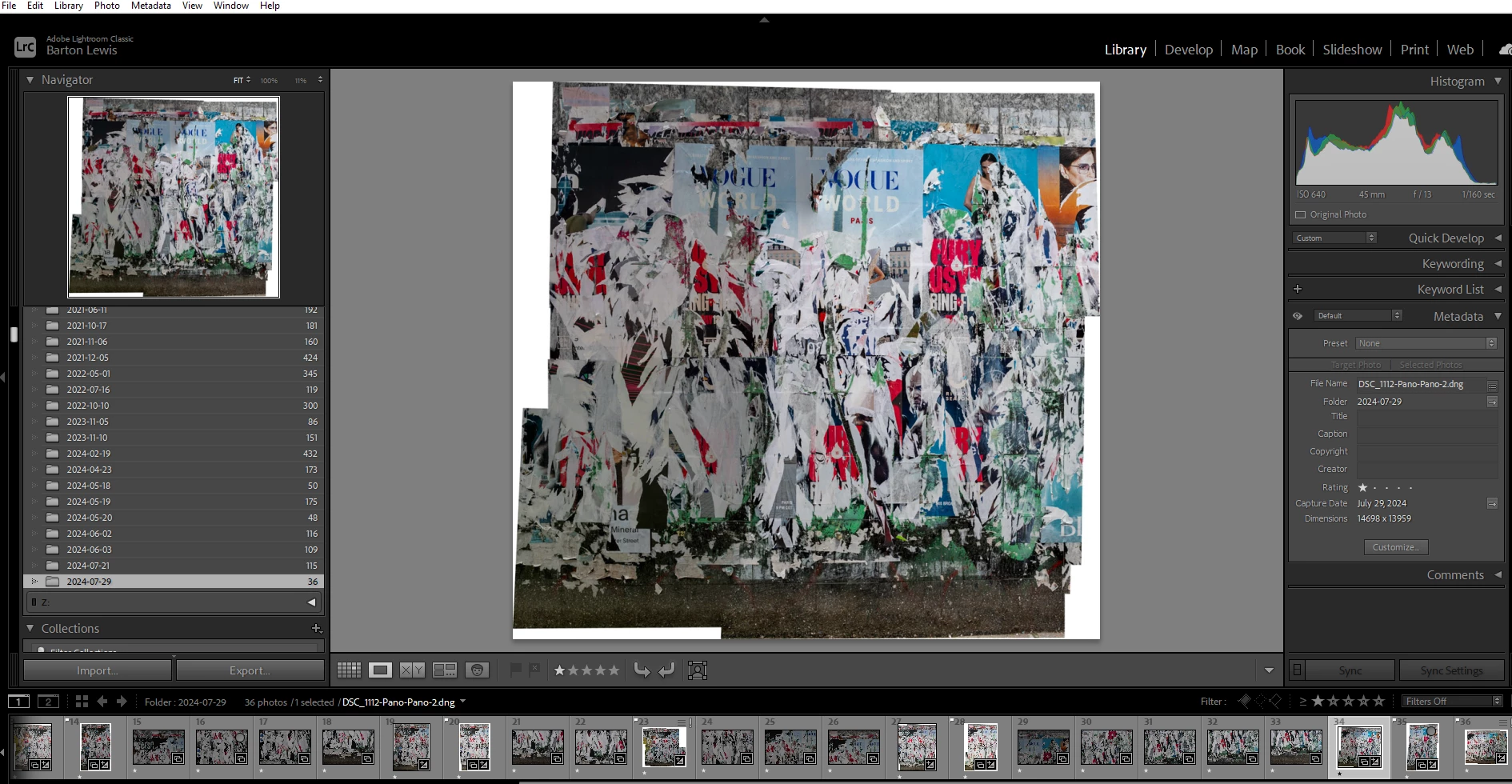

Aug 24, 2024 7:19 PM UTC
Right of course.  Thank you.  The screen shot shows the folder where these files are selected.  The folder does not have a question mark associated with it.  Also, there are 197 files in the folder on the drive, but only 36 reflected in LR.  Presumably those are the files I manually relinked.  The next folder on the drive (2024-07-21) has 115 files and this number is correct in both LR and File Explorer.  It's as if the 2024-07-29 folder was somehow deleted/went missing, then recreated and LR is starting from scratch.  But all the other folders (which were not copied to the portable hard drive, it's remembering.  I don't understand what could be going on and so don't know how to relink/resolve the drive.  Any ideas?
