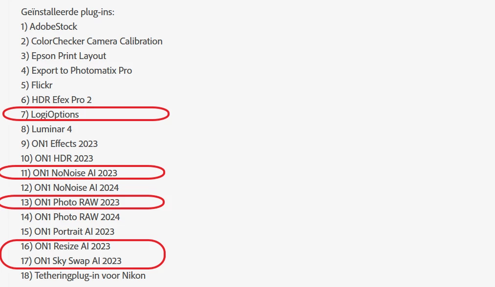

Following is probably not the solution to your problem, but I noticed the following:
1. LogiOptions.
 The Logitech Plugin, LogiOptions, not to be confused with the Mouse/keyboard drivers, or the mouse/keyboard control applicatin, Is a plugin that allows (on capable mice//keyboards) to assign functions to extra buttons/dials much like a LoupDeck. This plugin is a known piece of dung. It often cause annoying issues (main one being while batch removing photos) If you do not actually use it, then I would recommend deleting it. Note that (unless logitech finally fixed) it has a nasty habit of getting re installed during Logitech driver/app updates. If you do use the extra buttons for LrC actions, then Ok keep it, just accept an occasional annoyance.
2. Older versions of plugins. ON1 NoNoise, Photo RAW.
Not absolutely sure if the existance of older plugins is an issue. But that may be asking for trouble. These plugins, the files for them, are read by LrC upon LrC startup. As such, they are in the database management. Actually they should only crop up as an issue when using them. Oh, LrC might be ignoring them. But quite frankly, it is probably a good idea to remove them. Eliminate a possible issue.
3. ON1 Resize 2023 and Sky Swap 2023.
Never mind, my bad. Yes I see those two did not get replaced in the 2024 install of ON1, but still work. I have the Resize in my plugins, no issue.
etienne van sloun
July 5, 2024
THANKS! After update 13-4: all problems solved!

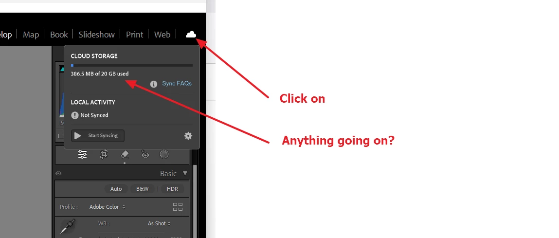

And my bad, I should have asked along with the system info.

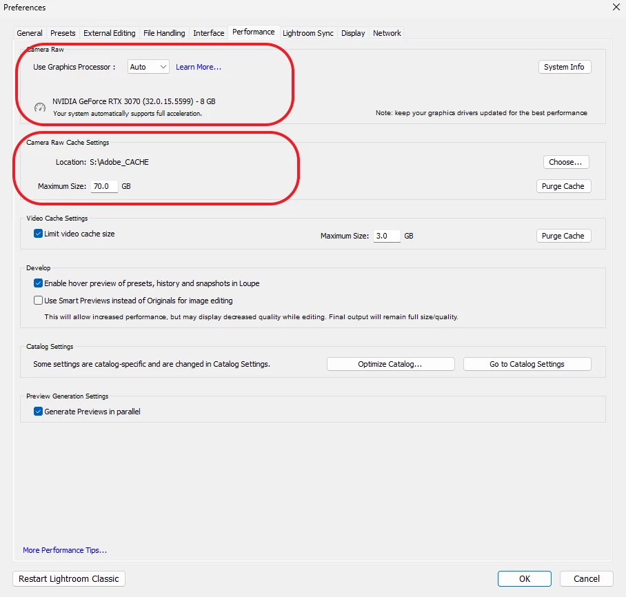

Can you post in a reply your LrC /Preferences/Performance/
and is any Cloud Sync going on?
etienne van sloun
June 26, 2024
no cloud - lightroom om C: and foto's on extra disk.
sync on pause
latest studio driver geforce RTX 1660
performance same as example

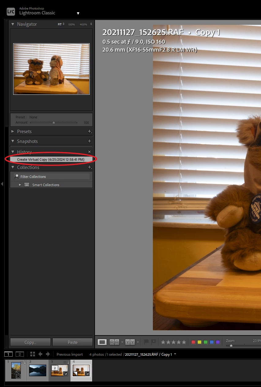

June 25, 2024
 thousands of virtual copies that I never made
Can you post in a reply a screeenshot in the develop module, with the History panel visible, one of those errant virtual copys.
