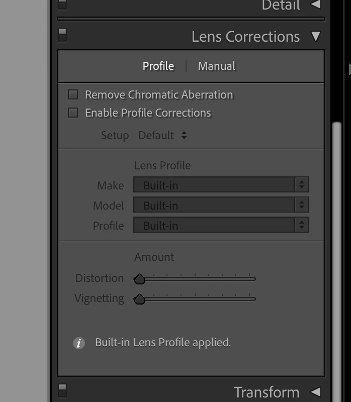

In the lens Corrections does it show that "Built-in Lens Profile applied" ?

I use a Sony A7 mirrorless but with Sigma Adapter. The last couple of years it worked without any problem. But since this update the actual Raw file is shown as "DT 16-35mm f4 SAM". I didn't change anything on the catalogue.

Using different brand lenses via an adapter has always been a challenge for Lightroom, because it the camera that writes the lens information into the metadata of the raw file. Lightroom only reads those metadata and interprets them. That interpretation is what you see in the metadata panel in the catalog. Nothing changed in the raw file itself, unless you are talking about only newly imported images that have this change.
Changing the metadata is not so easy (you need to use a plugin), but changing the lens correction panel is. Select the correct Canon lens manually, then select 'Save New Lens Profile Defaults' under setup.
