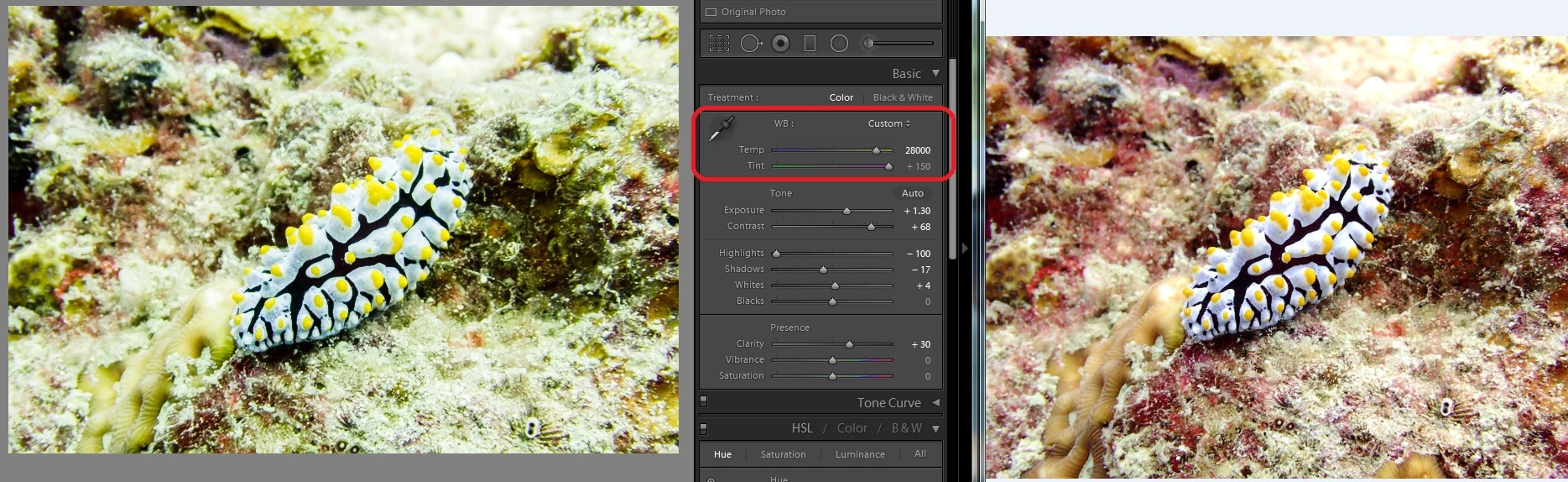

    Thanks for the suggestion, actually I've tried both adjust color temperature manually and use WB selector at beginning, but they're not perfectly working as expectation.

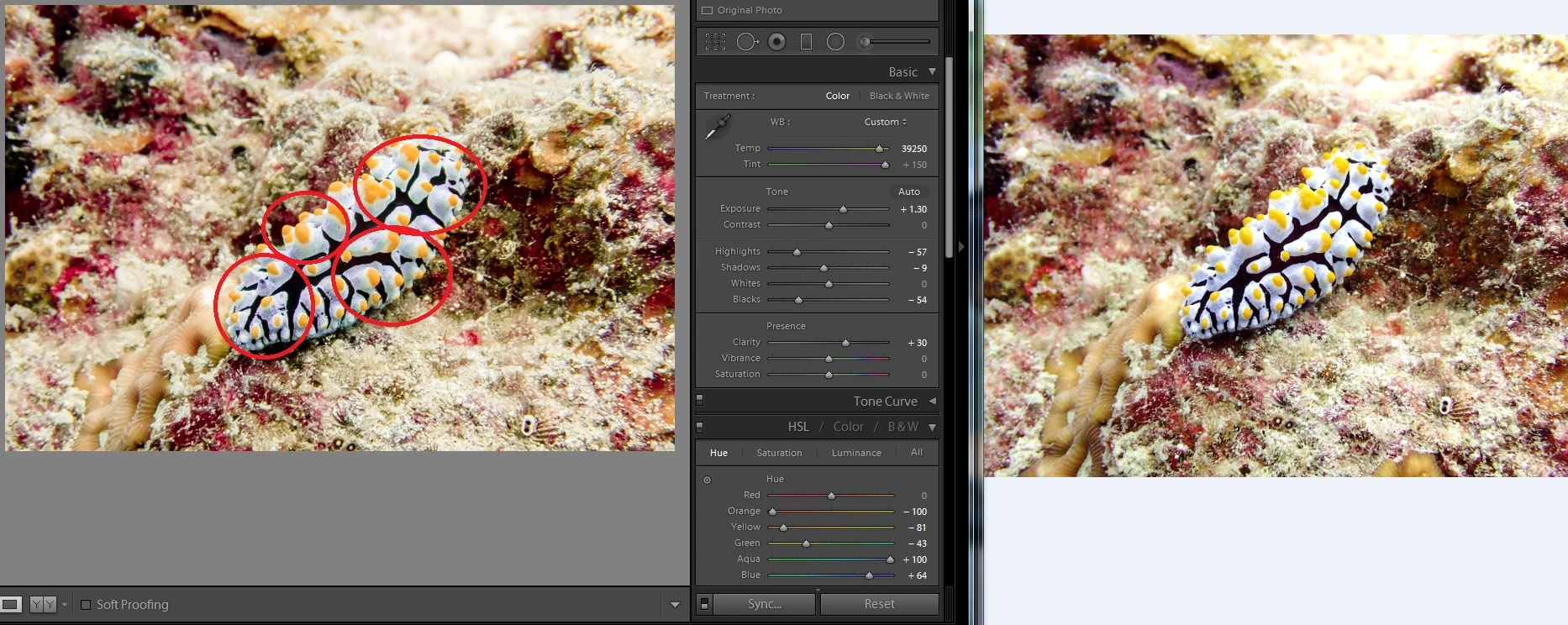

    1. You can see in right side is raw image adjust WB by pointing selector at sea slug white area in Olympus software, and left side is doing the same thing in LR, color temperature is auto adjusted and tint is already tuned to max value.
    2. If I adjust WB manually, and fine tune color in HSL section, ignoring slight color differen, thee image is close to expectation but unfortunately HSL color adjustment is not continuous and making strange green color in between.
