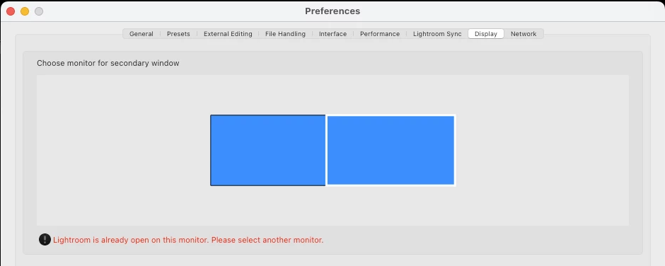

Daniel R Bynum
Aug 4, 2023 8:59 PM UTC
Hi there,
I would go under preferences, go to display and check the settings there. See my screenshot.
~ Daniel
