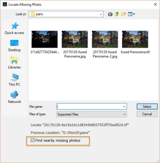

    It's a good idea to check this option:
    if not, LR will only redirect the exact file or folder that you have identified.
    Incidentally, it's the same for a folder as for a photo. The easiest way, is to re-direct the single parent folder that contains all of the photos. If that's not showing, you can use "show parent" on one that is showing - even if that folder is currently "not found", LR still knows what its full path used to be when it was found. So if even part of that can correspond with the new setup, you are all done.
