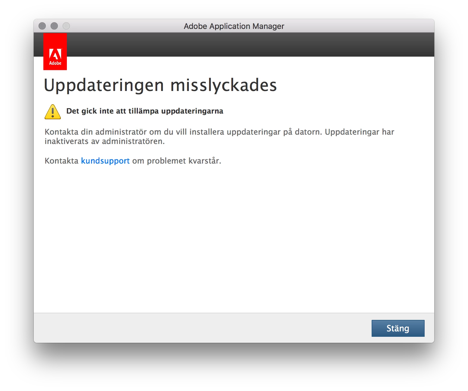

Tried to run the patch, this is the error message I got.
I tried the trial once, over a year ago. Could this be the problem?
Translation:
Update failed
The updates couldn't be installed.
Contact your administrator if you want to install updates on your computer. The updates has been deactivated by the administrator.
I guess I'm the administrator - but I haven't deactivated anything...
EDIT: I found the solution.
Renaming the AdobeUpdaterAdminPrefs.dat solved it for me.
Translation:
Update failed

CC 2015 [1014445] is not the latest version-  (Camera needs v6.5-  2015.5 ? if I am correct?)
Lightroom version: CC 2015.8 [ 1099473 ] is the 'latest'
Update to 2015.8 with the CC App.

Try updating from a direct download by installing the LR6.8/2015.8 patch.

I tried to do a fresh install (using the CC cleaner) and install it from the URL you posted. I only tried to download and install the full version though. I guess that's the latest version.
i will try to install the patch instead - see if that helps.
