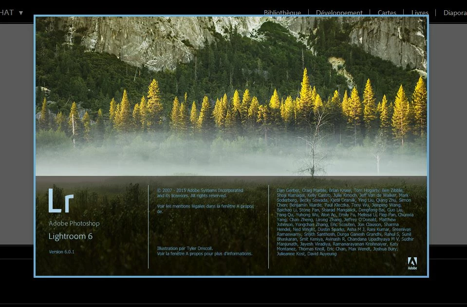

I would like to upgrade to version 6.7 but I do not know how to do it.
When I open Lightroom I go to "Help / Information System". I can read :
"" Lightroom Version: 6.0.1 [1018573]
License: Permanent
Operating System: Windows 7 Home Premium Edition
Revision: 6.1 [7601]
Architecture of the application: x64 ""
and I have this at the opening: (see image)

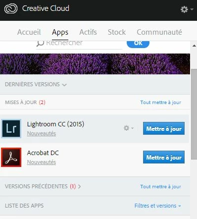

When I do "help / update", the Creative cloud page opens and offers me an update to lightroom CC 2015. (see image)
But I do not want lightroom CC 2015 !! I want to keep lighroom 6, the one I bought in permanent license and I would like to upgrade to version 6.7.
How should I proceed, please ??
JP Hess
JP HessCorrect answer
December 2, 2016
Lightroom 6 and Lightroom CC are the same program and are updated with the same update process. Since you have purchased Lightroom 6 and have activated  with a serial number, the program will run as Lightroom 6.7 after you run the update. You can't download a separate update for Lightroom 6 because there isn't one. It's all done with the same updater. It's unfortunate that Adobe doesn't differentiate that in the application manager. But they don't.
