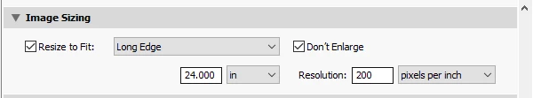

    I think what you are looking for is the "dimensions 4928x3280 and cropped 1834-x2755" . Is that what you are looking for?
    Yes, that's it, 1834x2755 is a little small for a 16x24 print. To get an export large enough, you'd probably want 200 pixels per inch, try these export settings
