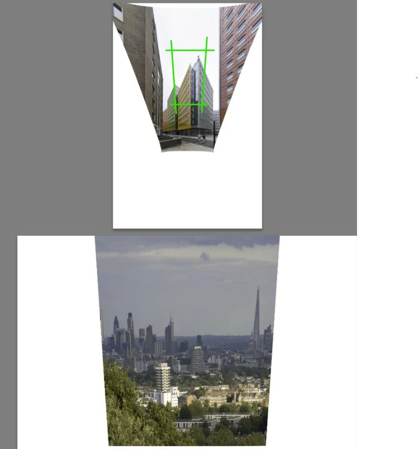

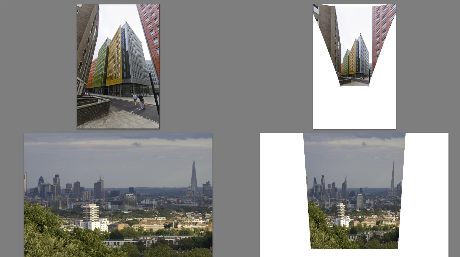

In my screenshot below, the top photo was with 10mm lens and the lower photo with 135mm lens, both from the same APS-C camera, both given -100 correction of Vertical in the manual transform panel for the right side version. I reduced these using Scale to show what is happening at their edges. The wideangle shot has clear geometric "warping" from the lens profile in addition to the perspective transform.
May 1, 2021
In fact, while effective results seem different I think the same actual transform is being applied per degree of angle of view. Within just the central part of a wideangle capture, the identical geometry and perspective are found, of what would have been seen with a longer lens. There is no such thing as wideangle or telephoto distortion, aside from this matter of included viewing angle and its consequences. Hence eyeballing the shape result of -100 Vertical for the telephoto shot and overlaying that onto the wideangle shot which also has received -100 Vertical, the two seem to compatibly sit within the same perspective change as below. 100 is an extreme transform, btw.
 If you look at what has happened to just the central part of my wideangle shot (inside the green lines) as compared with the uncorrected shot, that has undergone the same extreme vertical stretching seen in the telephoto shots, both the OP's example and my own.

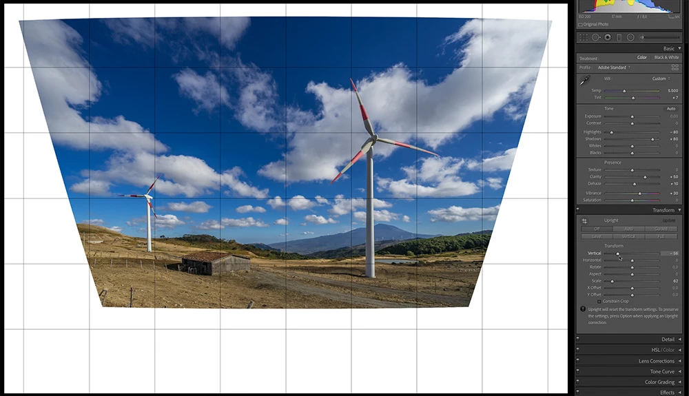

April 29, 2021
Nothing has changed and it still works the way it did work for me (I lowered the scale so you can see it well).
-- Johan W. Elzenga

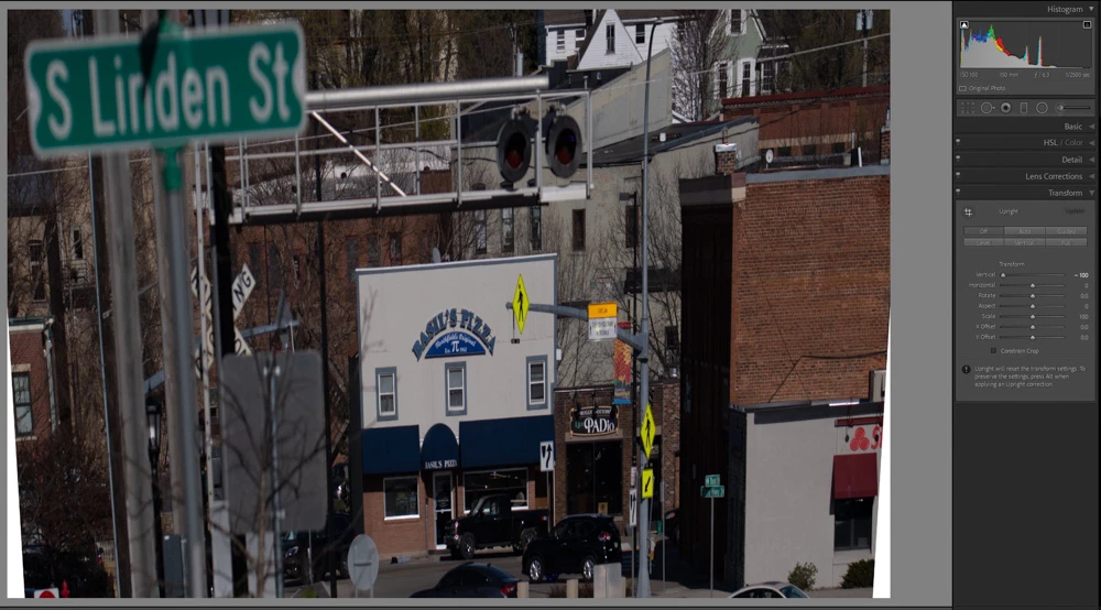

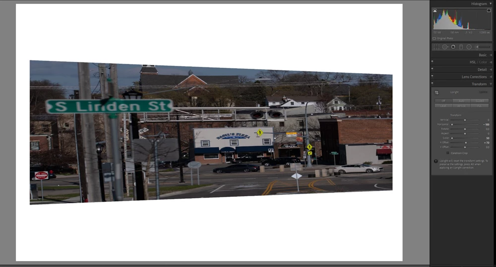

Mine seems to be drastically different now.  But I don't know why it changed.  It USED to look like yours.  Now it looks like this:

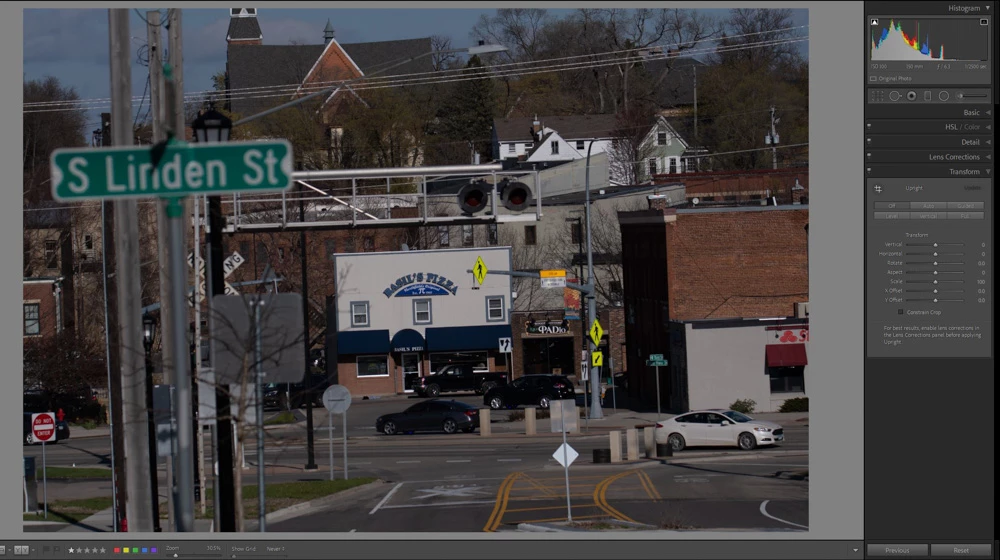

Here's the original image - ordinary D850 image (I'm testing a lens)
-100 vertical - HUGELY tall, very little parallax correction.

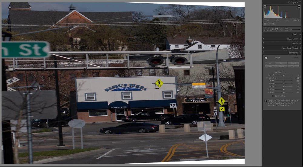

-100 horizontal - HUGELY wide, very little parallax correction.
Same -100 horizontal with the scale to -100 and x position so the whole image fits.  I don't recall this happening in previous version of LR, though I haven't had to do much so it may have been like this for the last year.  Is there some preference I need to change?
