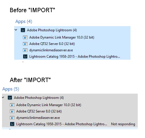

Today I encounter a new problem, running LR 6.12  on a Win10 64b computer.
If I try to import photos into any catalog LR 6 immediately freezes.
The Window "Select a source" eventially opens but is not functional.
I have attached the status described by Windows Task Manager, before and after the freeze.
My first reaction is that the application has become corrupted. Should I reinstall LR?
{Moved from Lightroom Cloud to Lightroom Classic Forum by Moderator}
Correct answer rsun36
I found the problem!
There are discussions on the internet about this particular crash occurring when an Android phone is plugged into the computer, and it disappears when the phone is unplugged. Apparently LR Import is somehow confused in it search for files to import. I had activted MS YourPhone to my Android S10 before this glitch appearred. When I turned off the connection to my phone the problem disappearred completely.
Go figure.

First up, that task manager screen more than suggests you are running a 32 bit copy of Lightroom, why? /update/ OP posted sys info, corrects this misunderstanding.
Second up, and this will require input from other members, or perhaps searching this community for a upgrade path to v6.14,/update/ sys info posted by OP shows v6.14, not v6.12
Third, please post your System Information as Lightroom v6 reports it. In Lightroom click on Help, then System Info, then Copy. Paste into a reply, please include info from first line down to and including plug-in info.
rsun36
rsun36Author
June 11, 2020
The two applets are separate functions from LR. I don't know if they are available in 64b or not
I looked up Adobe Dynamic Link Manage 10.0 (as 10.0.0.0) and appears to be only 32b
https://www.pconlife.com/viewfileinfo/dynamiclinkmanager-exe/
I am using LR 6.14
