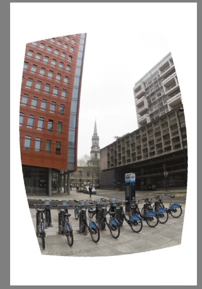

There are various aesthetic and compositional tricks to make this 'wideangle effect' less pictorially objectionable - there is also a converse 'telephoto effect' for long focal lengths. We are more used to seeing the latter and tend to mind it less. Or there are other tactics still - such as deliberately NOT going for a perfect rectilinear projection, but rather accepting a somewhat "fisheye" one. But since a rectilinear expectation has been built into the lens design - unless that lens is explicitly a "fisheye" one - trying to do this in software is a bit of a forced compromise, with some downsides. To play, one can try the Manual tab in Lens Corrections where there is a "distortion" slider - in sample below, I also disabled "constrain to crop" and used the Scaling in Transform panel to expose better what is being done to the image.
This photo was taken at 12mm on an APS-C sensor, the same as roughly 18mm on your camera. Unlike the rectilinear version, it cannot be viewed from any distance that would map onto one's natural view of the scene - when shown as a flat surface.
But one can imagine printing it onto a curved surface instead, which then could map OK with the scene as seen (grin) - but with viewing distance then becoming even more critical of course.
