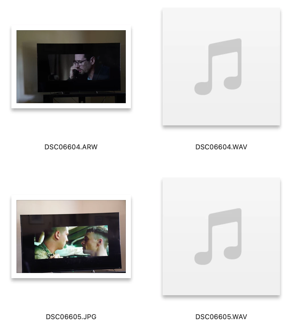

Yes they used to be separate as I can certainly play the audio on the camera.  Sorry can't transmit a catalog, we send in one photo at a time directly from the camera via FTP.
Yes the .wav files are present but figured it out for Lightroom!
1.  ARW or RAW files have the .wav files but do NOT show up in LR Metadata
2.  Shooting JPG files have the .wav files but DO show up and play in Metadata
On my side I'll have to have someone contact Sony as to why the .wav files do not show up in jpg FTP transmissions when they are on the camera.  That's another story 🙂

"ARW or RAW files have the .wav files but do NOT show up in LR Metadata"
Is that screenshot showing DSC06604.ARW/WAV in a folder on your computer or on the memory card?   If it's showing the folder on your computer, then LR Import has copied the .wav correctly but it isn't showing up in the Metadata panel.  If the screenshot is showing your memory card, then LR Import isn't correctly copying the .wav file to your computer.
