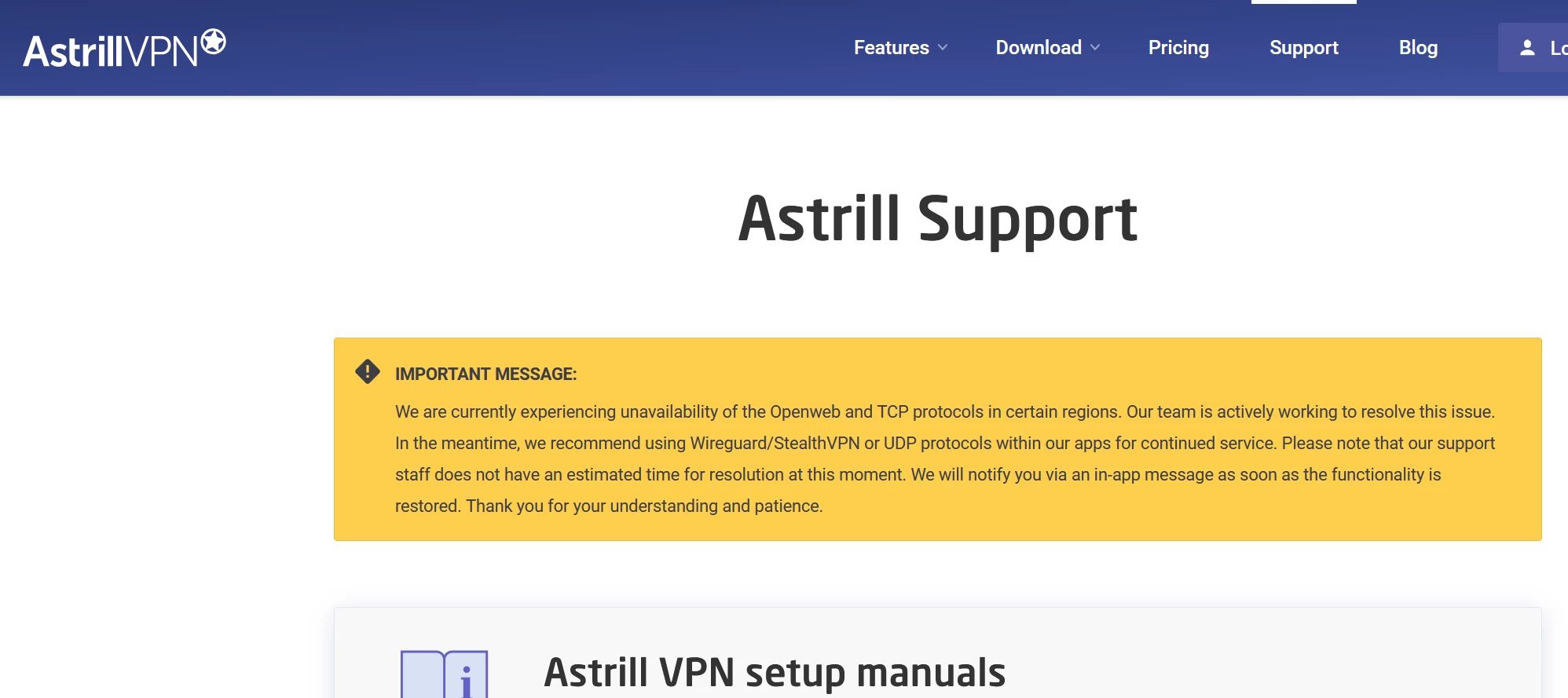

GoldingD
Feb 12, 2025 6:42 PM UTC
Started researching this by searching on Google, for this VPN and LrC. And I noticed on the support page that they are having issues. Perhaps this is a temporary issue.. Or perhaps not your problem in your region:
https://www.astrill.com/support
