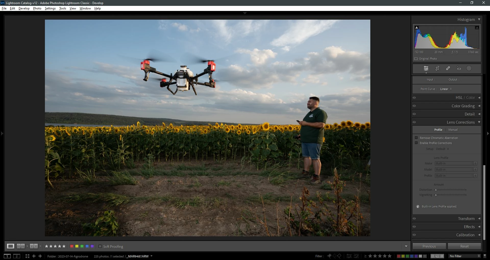

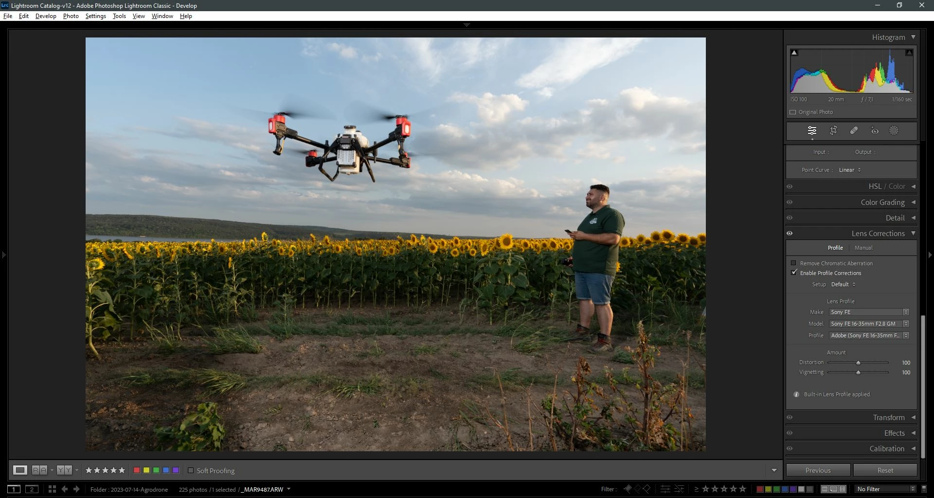

The lens correction profile on the Sony 16-35mm f2.8 GM make s the picture worse than it is. When applied it distorts the image arround the edges rather than fixing any distortion. And the vignetting correction is so strong it makes a white outline. I have to bring it down every time to 40% to be accurate, but the distortion is crazy off. The lens has so little distortion that it is barely noticeable. The profile makes it unusable and in my oppinion needs to be reworked. I have never seen a profile not work on all the cameras and lenses that I've used over the years.

Note that a built-in lens profile is applied. So you cannot/ should not click on the enable  profile correction box. Trying to force the corrections makes things worse.
JohanElzenga
July 20, 2023
quote
By @GoldingD
You can't say that without knowing what lens profile is applied (click on the 'i'). Many such profiles correct for chromatic aberration only. If a full profile is embedded, then usually Adobe won't provide their own profile.
