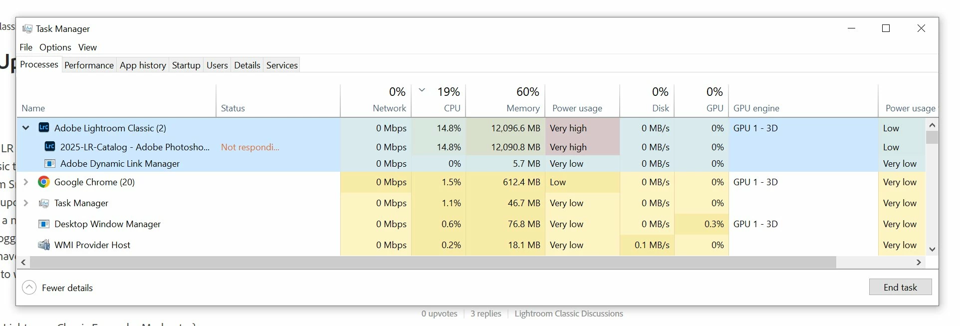

I've got the same problem, but noticed that if I upload files to a small gallery with few pix already in it, the upload starts pretty quickly. However, if I upload to a gallery with hundreds of shots already in it, the computer starts hammering the cpu and can take 15-30 minutes to start uploading. I have no idea what the computer is doing, but I'm wondering if its comparing the files I'm uploading with the files already in the gallery to make sure there are no duplicates? In the Task Manager, it shows Adobe "not responding", but that just means it's busy, as you can see by how much the cpu is working. My next experiment will be to upload always to an empty gallery first, and then drag and drop pix from there to the target gallery later.
