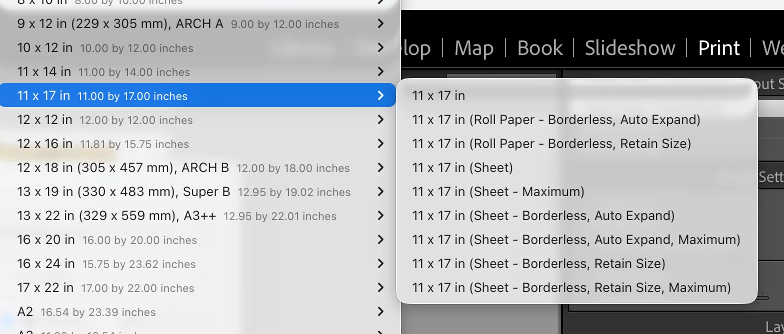

When I try to print from LR Classic on my up-to-date Mac M4 Mini, the “Roll paper” option is no longer available in the Print Module. Borderless options remain. But when I print with a borderless setting, the images come out only 10” wide, despite being set up larger. I uninstalled/reinstalled the printer (Epson P5300),  no luck. I can print from Epson Print Layout fine but want to print from LRC as usual. Any thoughts?

    ​@Sameer K Thank you! I followed those directions but came up with the same thing. And when I print with borderless setting on 17” roll, the image is only 10” wide.

    Thanks for the tag. This looks like a printer/driver issue on macOS, not a Lightroom Classic bug. The missing Roll Paper option and 10″ clamp are classic symptoms of a broken Epson queue or an AirPrint driver being used instead of the full Epson driver.
