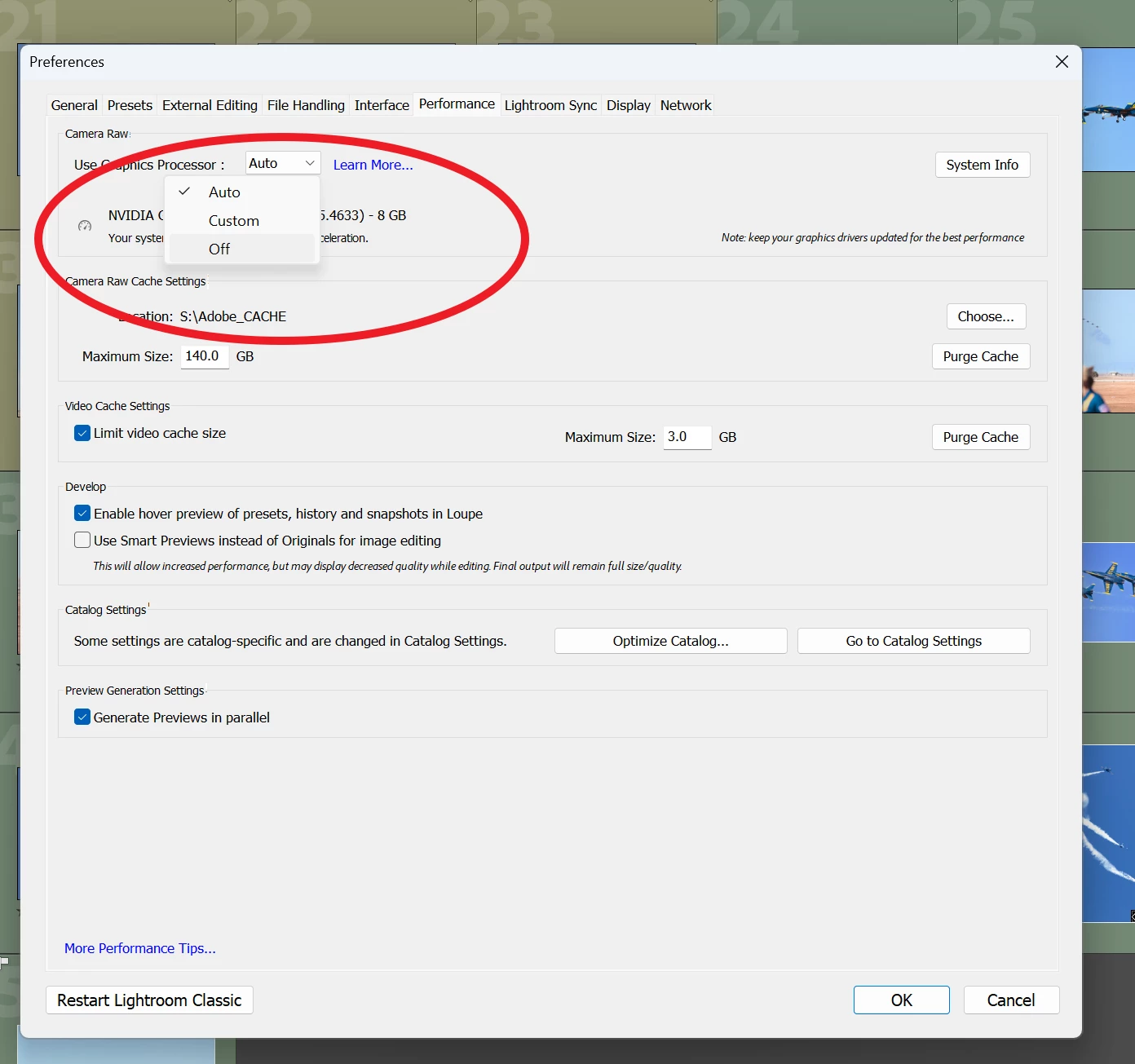

5. I should try using LrC with the GPU option off. However, I have no idea what this means or how I would do this.
When having issues with performance on a computer with limited GPU, or very old GPU's (so old that the mfg no longer updates drivers) it is often advised to try this and see if LrC behaves. If it does, then indications are the GPU or the GPU driver are at fault. And in the case of very old equipment, doing this might be the only way to get LrC to not crash. In preferences, in the Performance tab, in the Camera RAW panel, For Use Graphics Processor, you can select Off.
Their is no guarantee that this will solve anything, but you can try.
