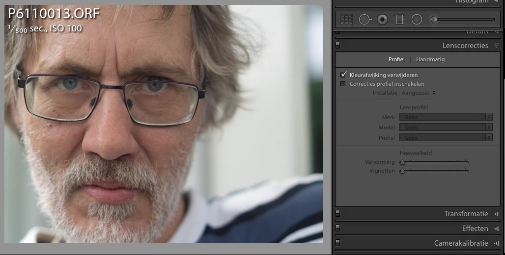

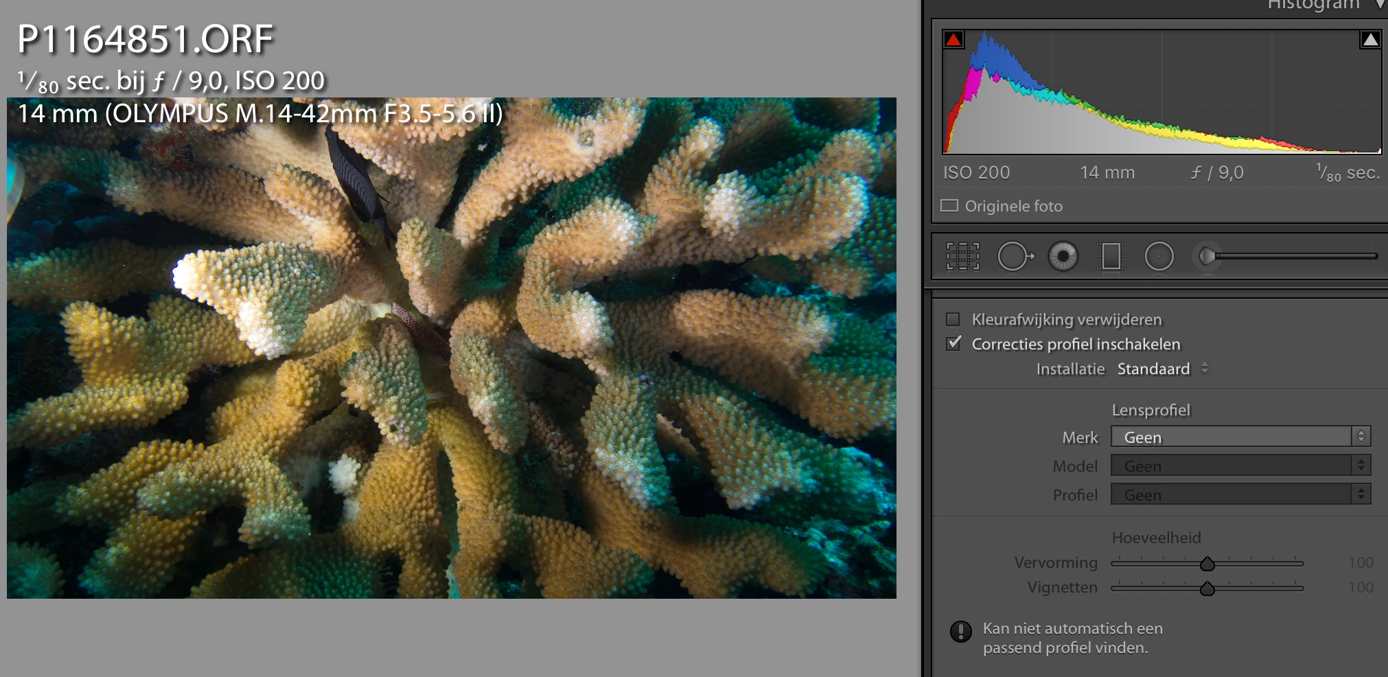

Hello all,
Recently had to re-boot my computer and reinstall my Adobe subscriptions LR CC and PS CC.

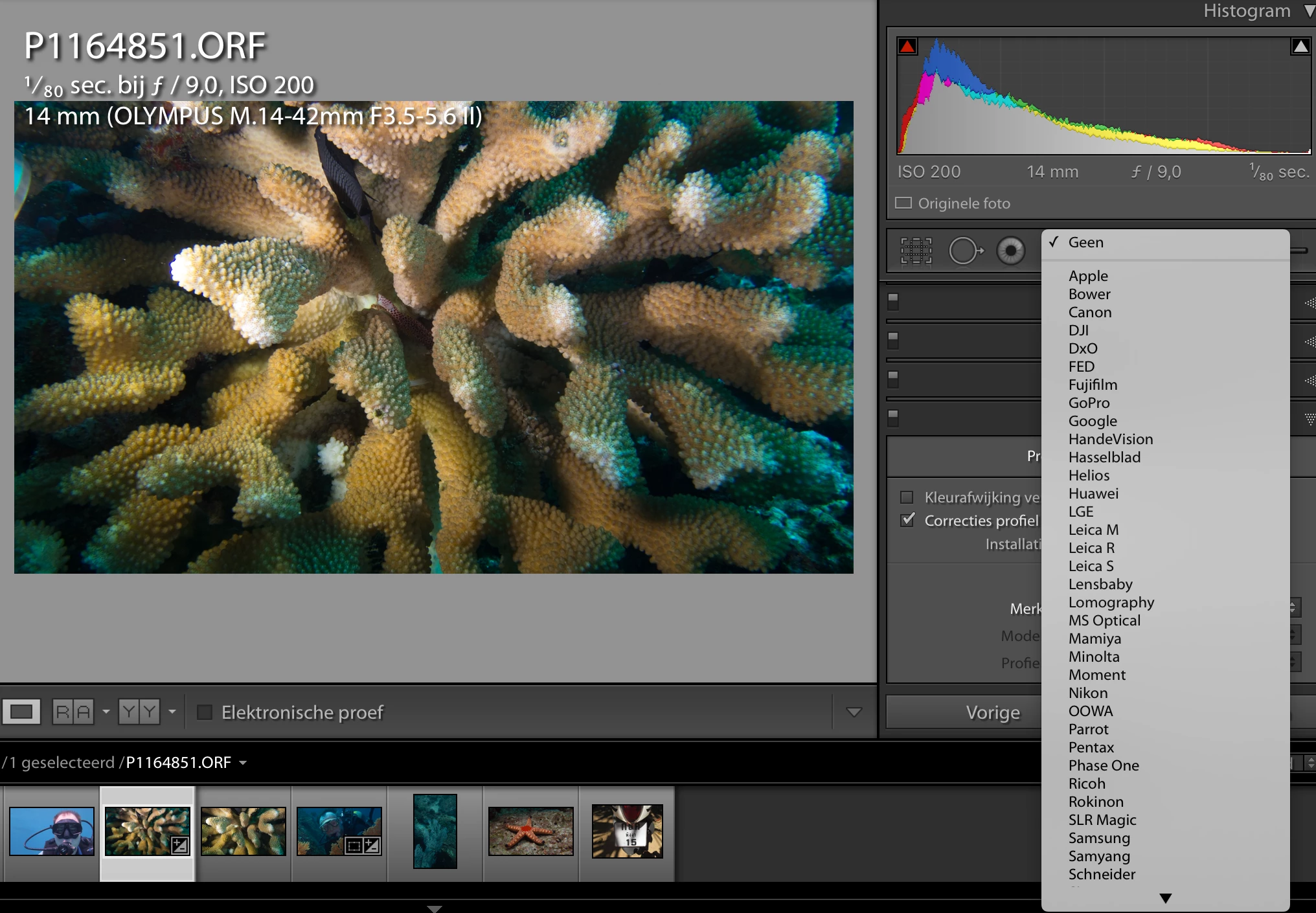

After that in Lens corrections the brand Olympus and lenses was not visible anymore.
TXT info: Can not automatically find a matching profile.
When I try to select camera brand, Olympus is not there.
However at the info next to the photos, all camera brand info and lens info is visible?
How can I get in lens corrections the brand Olympus and his lenses back??
Regards, Chris

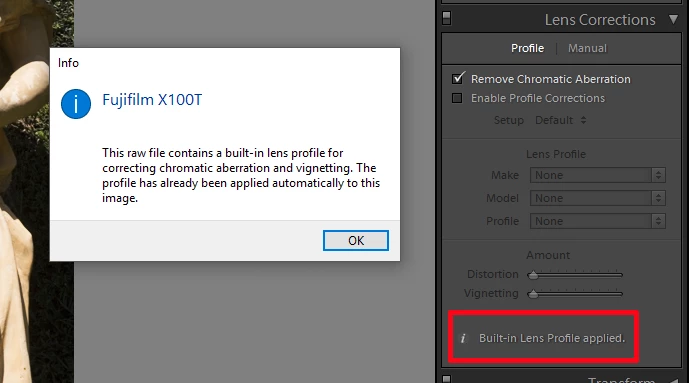

Un- Check the "Enable Profile Correction  and Click the ! mark near the bottom of that section.
As stated above the lens profile is Auto applied.

When un-checking Enable Profile Corrections and Checking Remove Chromatic Aberation, the build in lens profile is applied indeed.
But I can not check if the correct one is used.
Why only the MFT cameras (Olympus, Panasonic also missing). For the other Camera models all lenses
And I also work with older lenses manually. Photos made manually with an Olympus OM lens (50mm MC Auto-S F1.4) on a Olympus OMD E-M1 camera with manual adapter are not recognized.
And the lens profile of these OM lenses are also not present.
So 2 questions remaining:
1) Why only the MFT cameras (Olympus, Panasonic also missing) have no profile?
    For the other Camera models and lenses (I even saw lensbaby on the list) profile are present.
2) No profile present of older lenses, how about OM, Four Thirds lenses (like situation described above)?
Where are those profiles?
