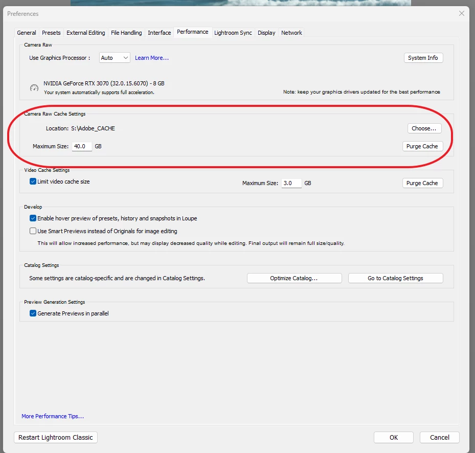

Can you post a screenshot of your LrC /Preferences/Performance/
Interested in your Camera RAW CACHE setting
