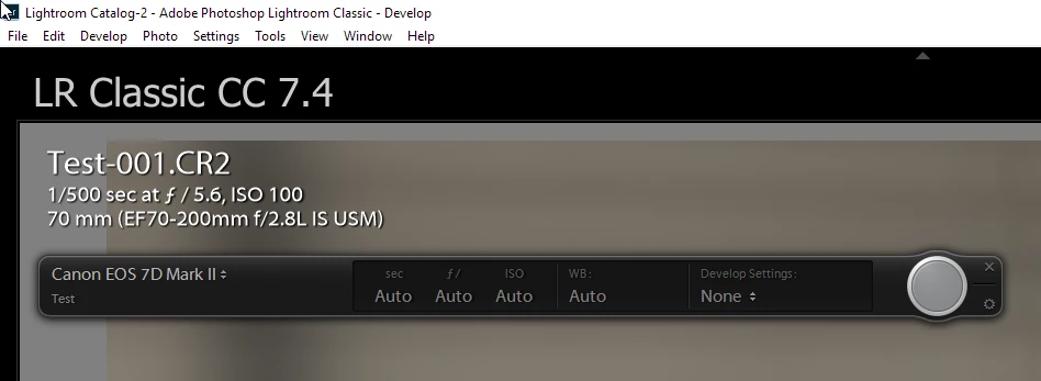

    LR 7.4 will do tethered capture just fine with my 7D.2.  I am connecting with a USB3 cable from one of my USB drives and it is less than a foot long and I am using Windows 10 with the 1803 update from April.  When I first plug it in and turn on the camera, I see a computer symbol on the camera screen, but once I start LR Tethering it switches back to the regular camera display so that is a clue that tethering is connected properly.
    Besides Windows recognizing the camera and letting me see the files, I don't have any other tether-capable software installed, not Canon EOS Utilities or Capture One so one of those things might be conflicting and grabbing ahold of the USB connection and not letting LR see it.
    Here is a screenshot of LR with tethering loaded and an out-of-focus shot of my window blinds taken with LR:

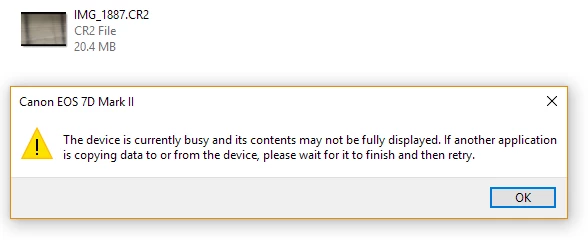

    When I first opened an Explorer window with the tethering control open I got a warning from Windows that it was busy but I closed that and refreshed Explorer and could see the images in Explorer, but only the first one I took, because the others are transferred immediately.
    So for me Windows 10 and LR 7.4 are seeing my 7D.2 camera and playing nice with each other.  Something else must be blocking LR from seeing your camera on your computer.
