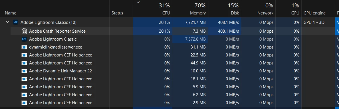

Rikk, I've followed your instructions to the letter. Clean reinstall & reboot for nVidia; clean reinstall of LrC (complete with interstitial reboots); purge of preferences. But I'm afraid since then I've had one runaway Crash Reporter - screenshot attached - and one total bluescreen.
I tentativelty report success with one thing: the hang/crash behavior seems to be mitigated by pausing Lightroom sync during editing of iPhone Pro Raw pictures that are sync'd with Lightroom Mobile. The behavior has only affected me with synchronized images in the first place, so all this seems to point to something in the sync behavior that is causing the issue for me.
