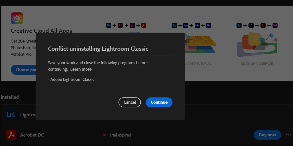

Aug 2, 2022 8:25 AM UTC
Apologies for the influx of messages! I noticed LRC was running in the background whilst looking deeper into my Task Manager (it wouldn't show up on the main list and was hidden). I've closed it down (it was running six times simultaneously...) and am in the process of successfully de-installing.
Will reinstall and take it from there.
Aug 2, 2022 8:21 AM UTC
And no error messsages come up when attempting to open LRC.
However this message pops up repeatedly (after click 'continue' the same pop appears) when attempting to deinstall it via Abobe Cloud:
