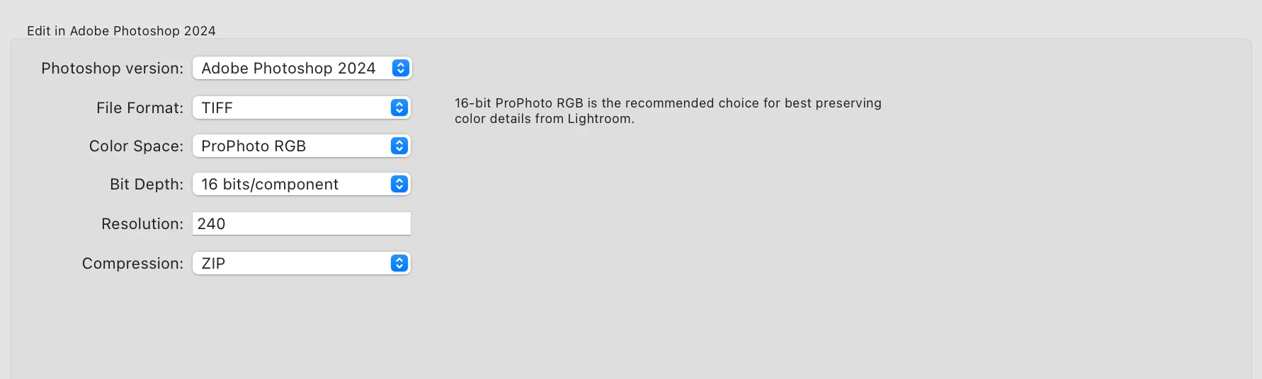

Hi @staceyc97341146 ,
When you open Lightroom Classic, go to Preferences -> External Editing.
Under the external editing tab, you should see a drop down which shows the PS version selected. Please confirm if you are seeing a drop down with PS selected?
If you are not seeing this, please open Photoshop seperately once and then close it. Now recheck if the preferences (shown above) is displaying Photoshop.
Then retry the workflow
Arjun
Sep 4, 2024 4:58 PM UTC
It is set to Photoshop 2024 already.
