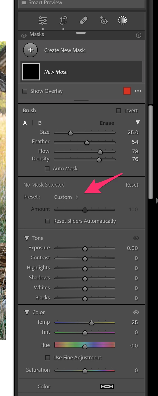

I've been able to create a Lua script that creates a new mask that includes mask type but I can't figure out how to add a mask preset (called effect in LrC 11) - by name ideally. Please see the screenshot of what I am referencing. Could anyone help with this?

I think your plugin will have to read all the local-adjustment presets (effects) and apply them itself. It's quite doable though with a few steps.
The presets are stored in this folder on Mac:
/Users/john/Library/Application Support/Adobe/Lightroom/Local Adjustment Presets
and in a similar folder on Win. Use LrPathUtils.getStandardFilePath() to find the folder on the current system.
The presets are stored in .lrtemplate format, which is a Lua-syntax data representation. It can be easily read using Lua's built-in loadfile().
To apply a preset you've read to a photo's mask, use photo:getDevelopSettings() to get the photo's current develop settings. Grovel through the structure (a table) to find the masks array and then the particular mask's table. You'll see in that table where to apply the local-adjustment settings you've read from the preset.
Then use photo:applyDevelopSettings() to apply the modified develop settings back to the photo.
It helps (rather, it's essential) in reverse-engineering this stuff to have a decent pretty printer for Lua values, e.g. from my Debugging Toolkit. The Zerobrane IDE seems fairly capable, but last I looked at it many years ago, it's pretty printer was primitive.

To clarify a bit: I am asking how to create a new mask with the mask preset already selected.
cwurzbachAuthor
July 12, 2023
Or, to be more specific. Is there a way to select a mask preset using the SDK?
Ian Lyons
July 12, 2023
I've no idea how you would load your own mask. That being said, the mask Preset drop-down menu that you've highlighted relates to the adjustment sliders (e.g. Exposure +1, Contrast - 10). You cannot load masks from the Preset drop-down menu.
