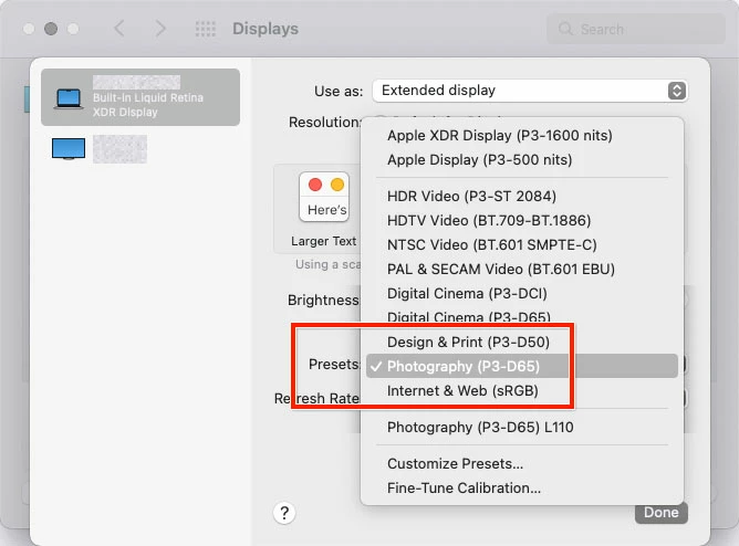

This is not an answer, but an attempt at troubleshooting…do you know if the results are more consistent if they set their Liquid Retina XDR display setting to one of the non-HDR Reference Mode presets that’s closer to the traditional display settings for print and photography?
And is the external display calibrated to any particular standard, or running at the out-of-the-box factory default?

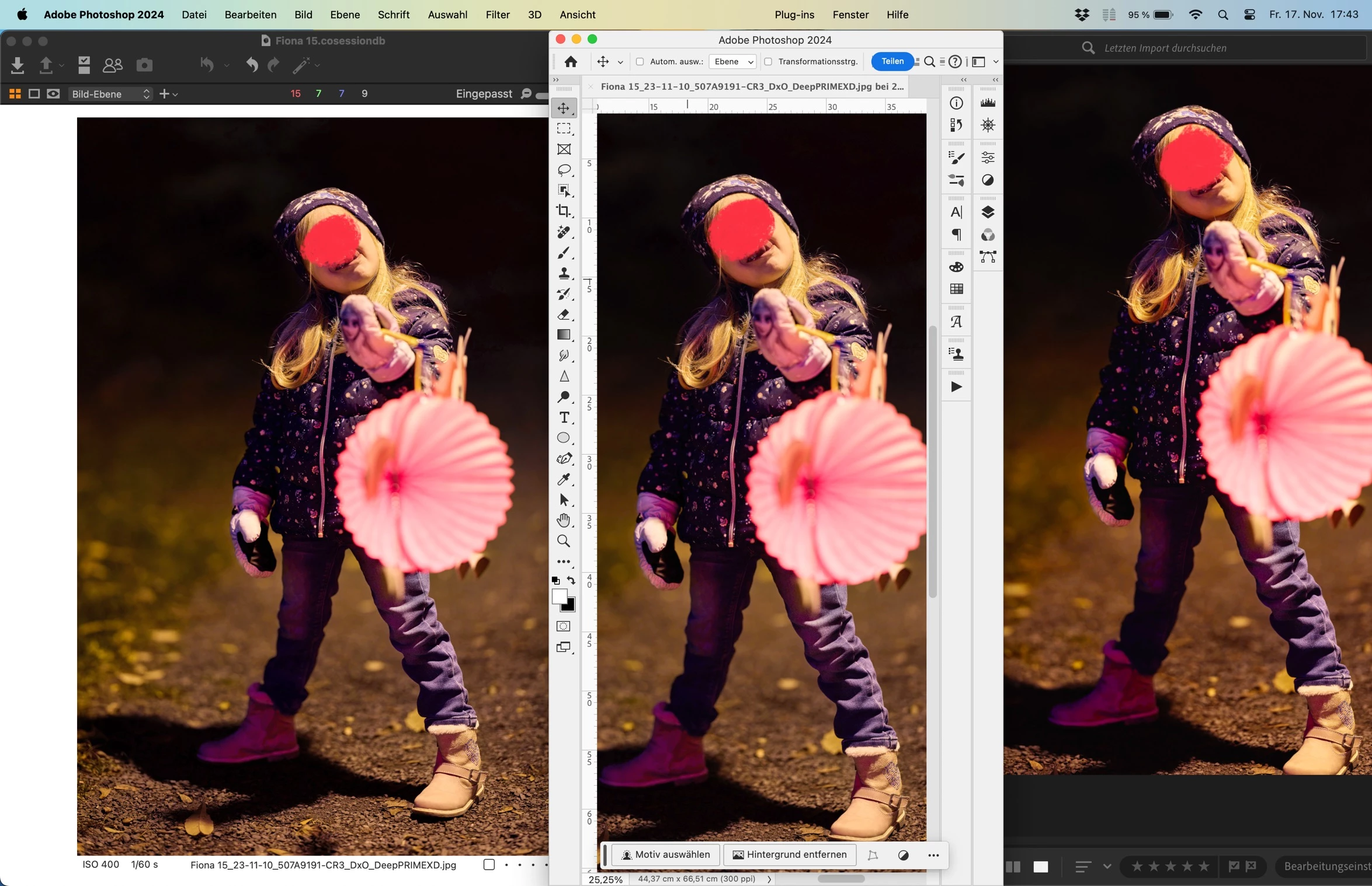

I just got my MacBook Pro with M3 a few days ago and stumbled across a similar issue. Some applications tend to show my images more contrasty and saturated than I intended - Lightroom being one example. I did change the Display settings to a custom Photography profile already, but it did not help. In fact I noticed that even the Lightroom App on my iPhone 13 shows the same issue. Photoshop on the other hand shows the colors just fine.
I am going to add a screenshot of the same image opened in Capture One, Photoshop an LR CC where you can see the difference.

In addition to above comments, you friend may find the procedure in this linked video helps in fine tuning the internal XDR display https://www.youtube.com/watch?v=bqF_SQWv8x0

That was a really helpful video (and way beyond what my friend will need at this point;-). Thanks for sharing it, Ian. Much appreciated.
Ian Lyons
January 18, 2022
FWIW, I stopped at setting the 'SDR' value (screen brightness), which is around 4 minuntes 30 seconds through 5 minutes 25 seconds into the video. The value I've calibrated my external displays to is 120. So, that's the value I manually input for the SDR value shown in video at 4 minutes 34 scenonds.
If nothing esle, I recommend that your friend does above, especially as the screen is too bright by default.

Thank you, Conrad! That's very helpful, I'll try those settings with them and will report back.
I don't think the external display is calibrated to any particular standard, it's probably set to 6500K but that's pretty much it. I'll try to find that out as well.
