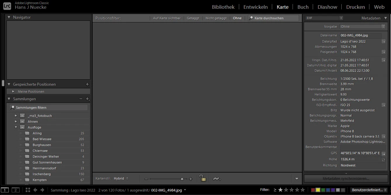

I am "since ever" on the latest versionwith CC, and the CC-Desktop tells me "no new Updates available".
But since the last time I used the Map function (probably a month ago) I see no longer a map, although the Meta Data shows a GPS position (in LR as well es in Bridge).
So it shouldn't be a matter of my version!
What's going wrong her?

Rarely this can be due to a problem on a Google Server that is contacted to apply the maps (Adobe uses a third party for the maps, i.e. Google), If Google maps is down in your area, then it will fail. Might be fixed in the morning. Might not be the problem at all.
Sometimes you just need to close LrC, then start LrC.  BIG HUGE NOTE: If you do this you need to go to the library module, then close LrC. It will not work (that is get fixed, if you are in a different module like MAP, or Develop) I have no idea why.

I have the same problem today with LR9.4 map not showing at all (creative cloud subscription). I cannot upgrade to a higher version of LR because I am on WIndows 7. I could give you a hundred reasons why I am unwilling to do a clean install of windows 11, starting with the fact that I'd have to spend a fortnight baby-sitting my PC whilst it installs over 100,000 application files and I just don't have the time. This Adobe support page https://helpx.adobe.com/lightroom-classic/kb/map-view-no-longer-supported.html  says the map module doesn't work on LR7 or earlier, but makes no mention of LR9.
Map failure is a bit of a nuisance.
Ian Lyons
April 28, 2024
Does LrC display the dialog shown in the linked article? If not, then the map issue you're expereincing may be due to a known bug. Basically, if you quit LrC whilst in the Map module, then next time LrC is relanched the Map will not function. The workaround is to switch to the Library module, then relaunch. The Map module should now function as you expect. However, you should remember to switch back to Library before quitting otherwsie the bug will occur again.

Rethinking about my last statement and trying to remember I must admist that the last time I used the map module in LR might be bac a bit longer; but pretty sure in 2023. I am using map functionality a lot. Usually I read exif data out of photos and offer a little icon in a photobook with  photos that opens a leaflet map to show the place where the photo has been taken. Usually those a smartphone photos taday, with automaticilly adding such geo positions.

UPDATE
  • I checked the minimal requirements (which, as I understood, are unchanged since several versions).
    And found out that even with "only" 190GB free space left on my disk, 32GB RAM , an
    AMD Ryzen 7 2700X Eight-Core Processor, 3700 MHz and 8 kernels, a fast NVIDIA GeForce GTX 1060 6GB and the latest build of Windows 11 I defefinetely should be on the safe side 😉
  • I then nevertheless uninstalled all BETA versions of Adobe products, cleared temp folders and trash and  all in the download area. And with that saved more than 40GB.
  • I double checked the update options and version details, and still could not update
  • I then uninstalled LR and did a fresh installation.
    And that finally solved the problem:
    I was informed, that the LR libary (catalog) would be converted, what gave big hope 😉
    And indeed: After the conversion LR started and this time showed version 13.2.
    And the map modul is working again!
