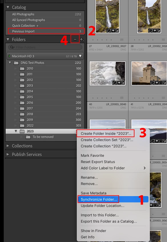

The process of finding and moving the files from the folder is relatively simple, albeit involves multiple steps.
I've attached an annotated screenshot showing the steps, etc.
A - You say that the files you want to relocate are in the same folder as some that are already in the LrC catalog. Therefore, your first step is import the other files into the catalog. It may seem odd, but stick with me. Rather than use Import, you should use the Synchronize Folder (1) option found in the Folders panel's context menu.
B - After the import is complete you should see that 'Previous Import' (2) in the Catalog panel has a file count. These are the files that were not previously linked to the catalog.
C - The next step is to use 'Create Folder Inside "xxxx"...'  (3) option found in the Folders panel's context menu. This creates a subfolder within "xxxx"
Note that "xxxx" is the name of the folder containing the files that you had originally cataloged and want to keep in LrC.
D - You now have an empty subfolder within "xxxx".
E - Now select 'Previous Import' and use 'Select All' (Cmd+A) to select all of the recently imported files, then drag the selected files to the newly created subfolder within "xxxx".
F - Now you need to switch to the Finder.
G - Using Finder, locate the newly created subfolder within "xxxx' and move it to the location that you'd prefer the files to be (e.g. a different drive).
H - Switch back to LrC and select the newly created subfolder within "xxxx". Don't worry whether the subfolder or the files within it have a '?' as this just indicates that the subfolder/files are no longer linked to LrC catalog.
I - Click on the '-'  (4) button at top of the Folders panel.
J - Choose 'Remove' when the dialog appears. I've included a screenshot below for reference.
