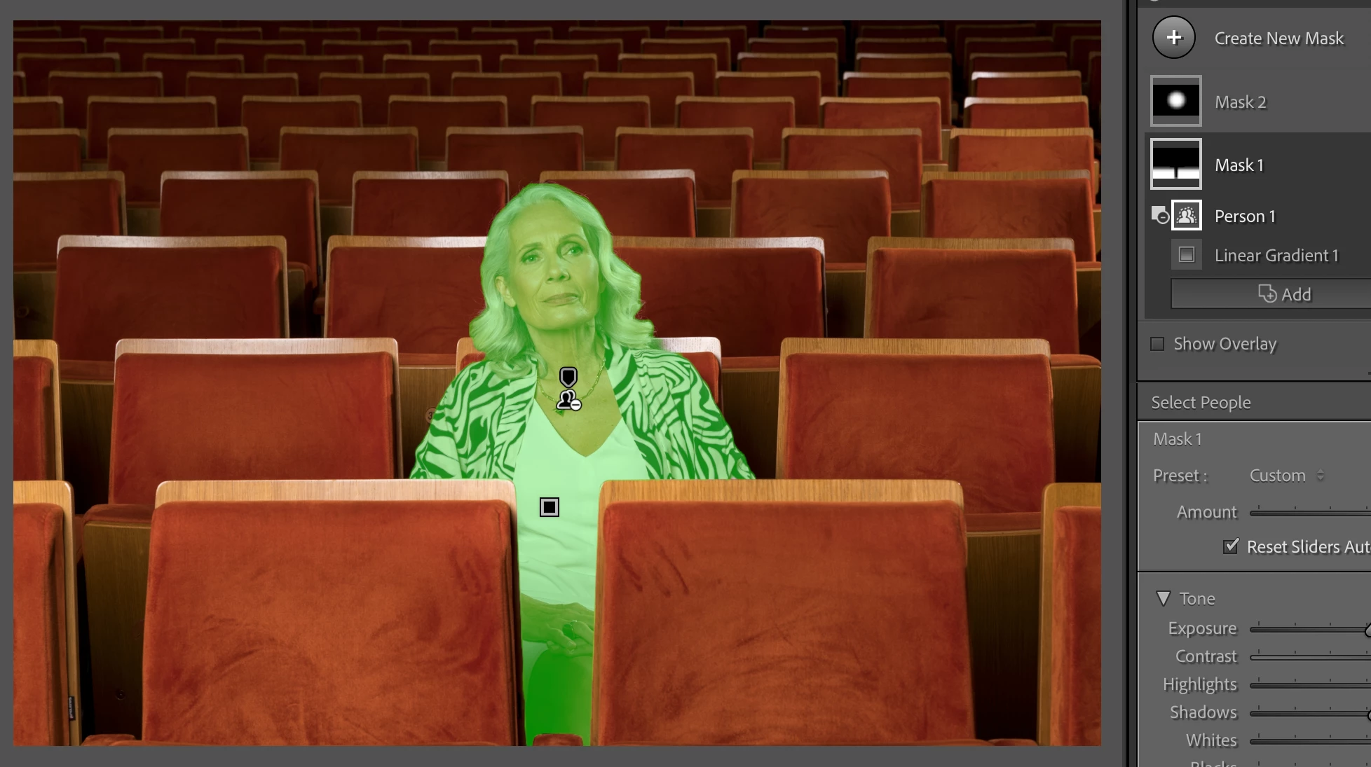

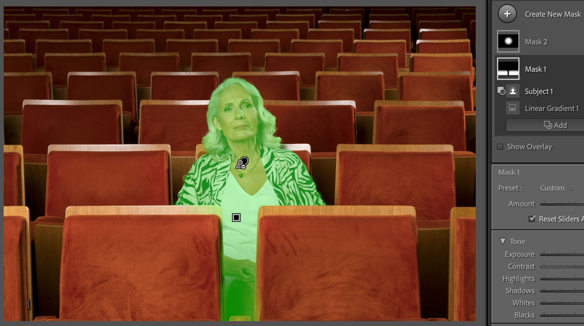

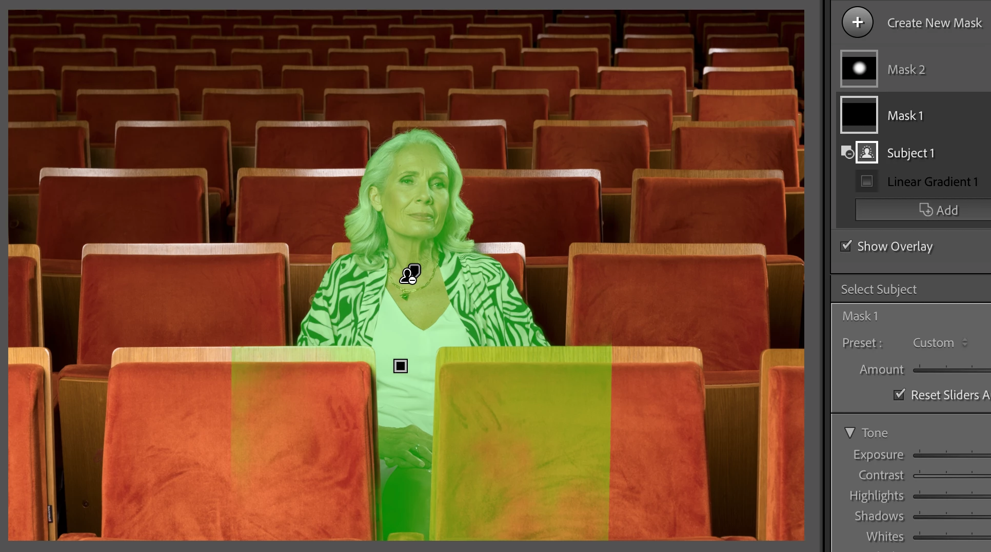

I looked at the individual mask components (Linear Gradient, Subject, Radial Gradient), and the Linear and Radial Gradients look fine. The issue is the funky Subject mask on IMG_4049, which has picked up parts of the seats, but on IMG_4050, it's fine:

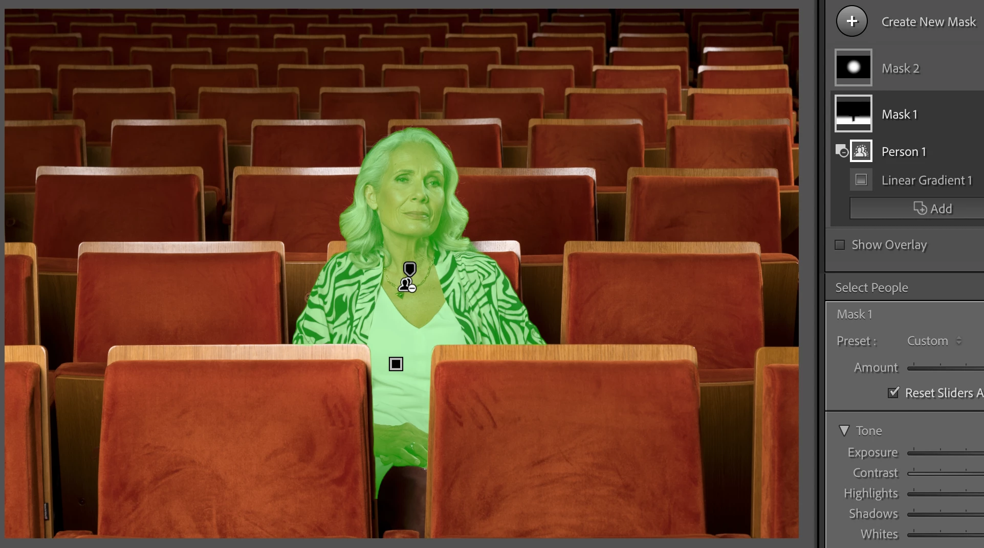

There are many posts here observing that Subject masks often make mistakes with people. Usually you get better results using People masks, which look like this on the two photos:
It didn't pick up the dark knee in IMG_4049, but otherwise they're identical.
When I replace the Subject mask in IMG_4049 with a People mask and then copy all the settings to IMG_4050, I get good results. Similarly if I reset IMG_4049 and copy from IMG_4050.
