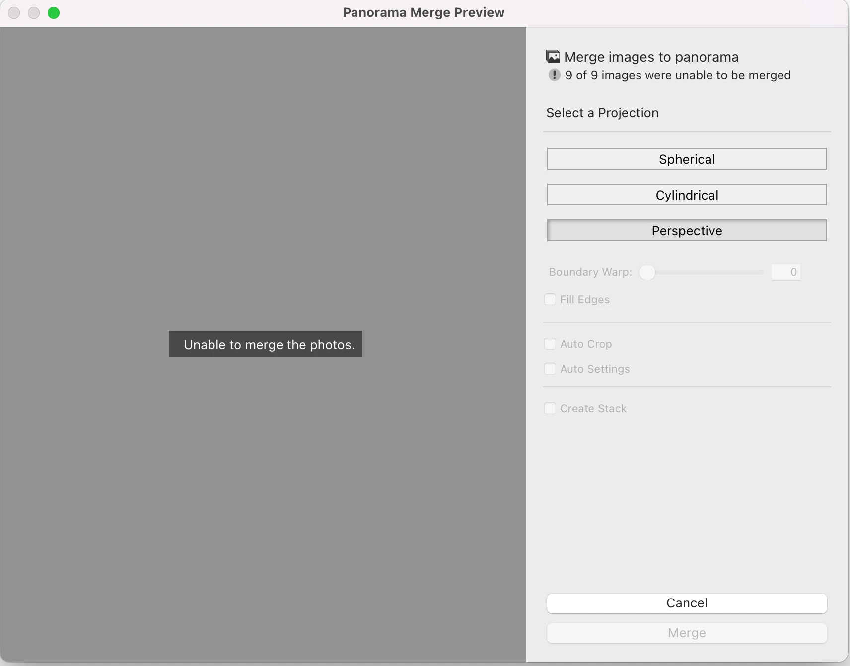

I shot panorama images in RAW (9 images total)  with the new Mavic 3 Classic and I'm unable to stitch them with the perspective mode in Lightroom 12.0.1.

having the same issue with a mavic 3 cone. the problem is the new panorama 3x3 mode from the mavic. dji says its a feature... and they dont want to change it. the gimbal rotates when capturing the panorama - every row has a different horizon-line. its terrible

I'm surprised nobody else has encountered this issue when most professional use this feature to generate panoramas from the DNG. I was told that the issue is that the new Classic lens is now 24mm, the previous Mavic 2 is 28mm. The stitching of perspective mode is only good at 25mm and above, 24mm is too wide.

Well i have following information by german dji support:
The M3Cine Rolls its Gimbal (at Row 1 and 3 to the inside) for a higher degree as you tilt it down when starting a 3by3 Panorama. And i can confirm that - when i begin a 3by3 with 0 degree tilt i have no issues. When i begin it with -15 degree tilt you will see images at row 1 and 3 like below. Therefor the Roll is different at every of the 6 images in the Row 1 and 3. This is not processable by lightroom. You can indeed process it with ptgui or autopano giga or different specialised software for stitching. Thats a real bummer for me too - but dji says its a feature to make in-drone stitching faster...

Whether or not you can use perspective depends on the angle of view, so the fact that you can do this with a different drone model does not say anything. Think about it: how on earth would you create a perspective panorama that covers a greater than 180 degrees view? I'm not saying that the Mavic 3 Classic does create a larger than 180 degrees view (I have no idea what it creates), but I trust you get the idea. Perspective stops at about 120 degrees in practise.

Try Cylindrical or Spherical. Cylindrical if just one row, Spherical if multiple rows/columns? Or just try one then the other and see what you get.
Nov 28, 2022 8:01 AM UTC
Cylindrical and Spherical works but the outcome is very different from perspective. I have tried exporting images and use PS but still cannot make proper perspective stitches. As I said the panorama files from Mavic 2 works perfectly, some the images from Mavic 3 classic all don't work.
