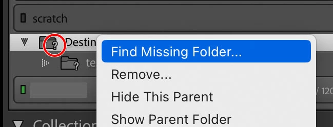

Hopefully this next thing isn’t going to happen, but if for some reason the catalog shows all of the folders/images as missing (question mark icons) when you open the catalog on the Mac Studio, you’ll have to re-link the top level folders on that volume. If all of the images are within a single parent folder, you can manually reconnect just that folder, and Lightroom Classic will automatically reconnect all subfolders. If you have to do this, right-click the folder, choose Find Missing Folder, and select that folder on the external volume. (If right-click isn’t enabled on your Mac, Control-click the folder to see that menu.) But hopefully it will just work.
