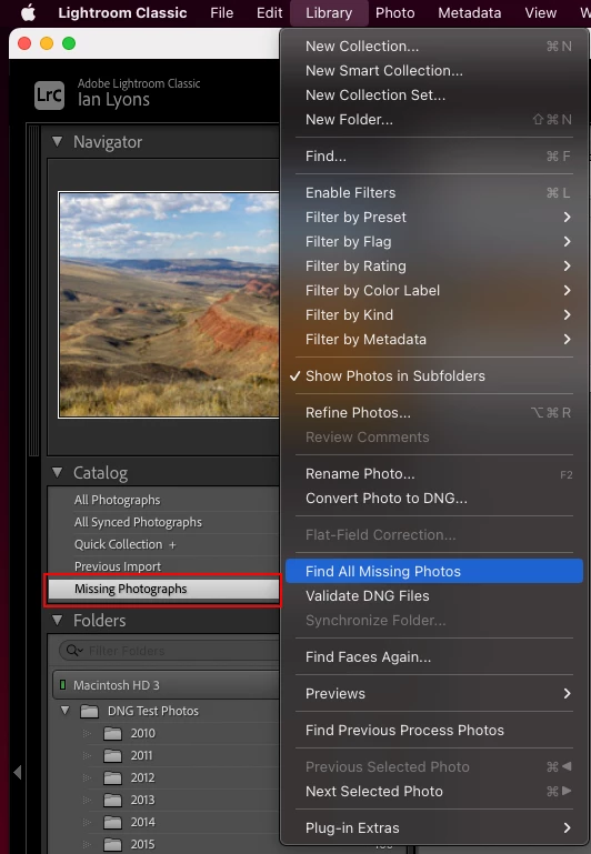

Ian Lyons
Aug 3, 2023 2:35 PM UTC
You can only have one catalog open at a time. Therefore, best you complete the tasks in the first catalog before relaunching LrC into the second catalog.
To find the missing photos in the second catalog, it would be quicker to use 'Find All Missing Photos', which can be found under the Library menu. LrC will then find all of the missing photos and create a collection within the Catalog panel as shown in attached screesnhot.
