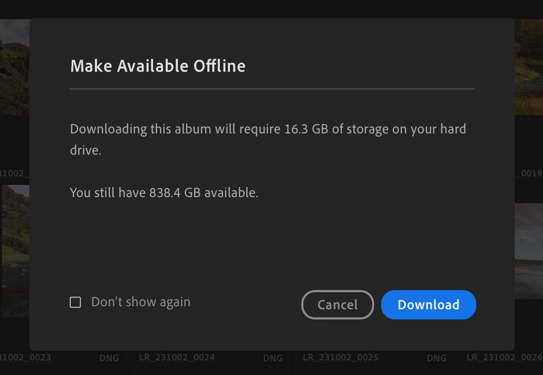

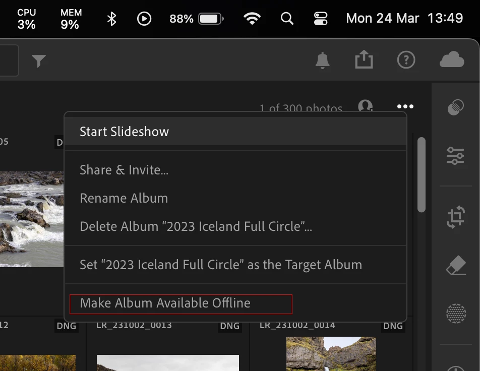

Are you using Lightroom (cloud focused version) or Lightroom Classic?
If Lightroom, then you can download the album and it's contents to your computer using the the 3-dot menu just below and to left of the cloud icon at top right corner of the application UI. I've attached some screenshots that might help.
