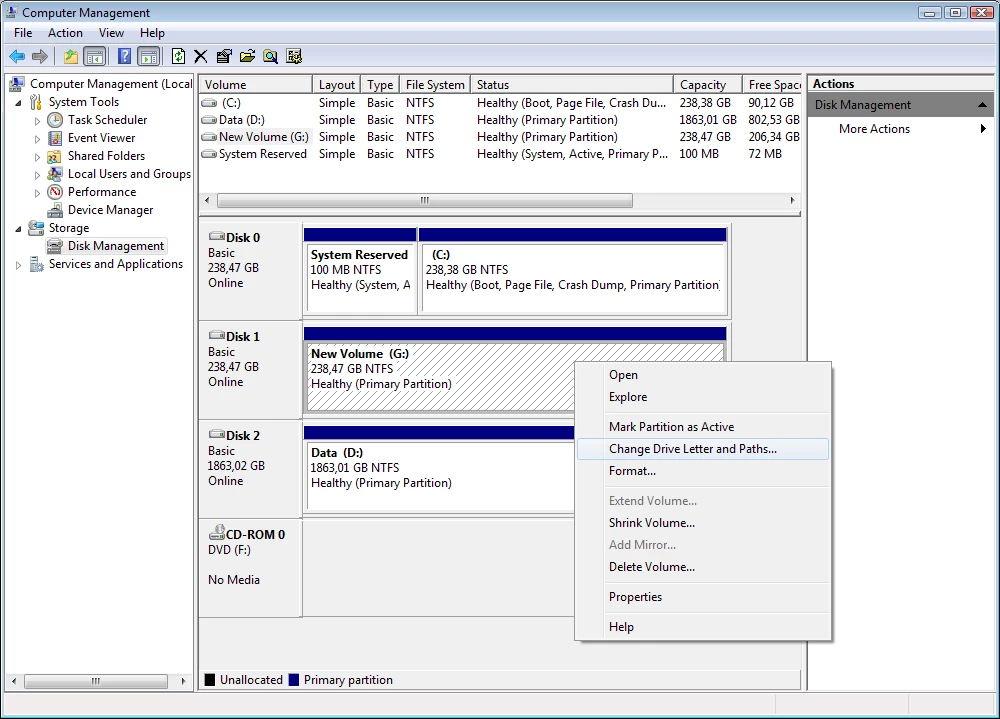

    Make sure that the external drive is labeled  L on the new computer as well.
    If it isn't, right click My Computer, and choose Manage, you can then assign a new drive letter to the drive.
    All the edits and metadata are in the catalog, and will not be lost.
