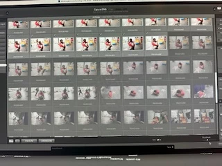

Correct answer irvingg65197455
 In addition to posting my isssue on this site, I also posted it on Fred Miranda and someone responded that grayed out images could mean that the images had previously been imported.  That triggered my memory that, indeed, I had imported the SD a bit earlier and then, for some reason had decided to delete that import and start again.  Well, I screwed up and deleted only some of the images, and that created the problem.
Thanks to all who helped.

April 13, 2024
Are the missing images grayed out?  Can you post a screen shot?
irvingg65197455
April 13, 2024
Good question.  Yes, the missing images are grayed out.  I've tried checking and unchecking but that doesn't work.
Here's a screen shot.
Thanks for your interest.
