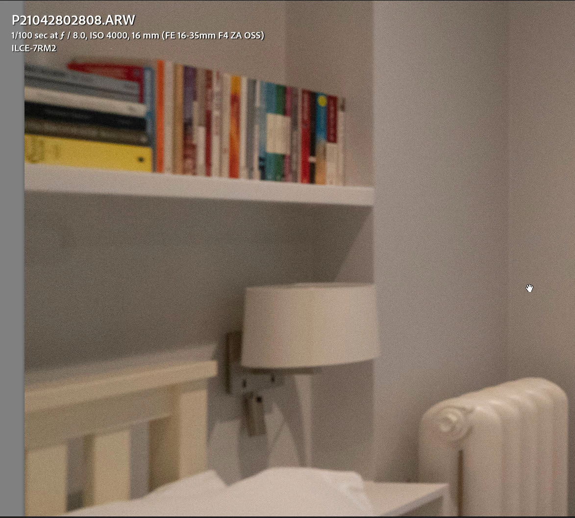

I have 77 stacks of 3 images shot with braketing -2, 0, +2 EV. Of the 77 sets 6 sets come up with a photomerge error saying there isn't enough matching image. As far as I can see they should be a perfect match. This is only happening to me with the latest 10.2 release of Lightroom.
I think I can also detect that of the ones that worked they appear to have more noise than I am used to seeing, but I haven't really investigated this thoroughly.
I'm using the latest version of Lightroom Classic on the current build of Windows 10 at this point in time.

The bracket set you uploaded is out of focus and nothing in the picture has edge detail. Edge detail is required to 'Auto Align' the bracketed images. It appears you used a tripod so unchecking 'Auto Align' in LrC Photo Merge HDR works and produces good results, but of course still out of focus! Try using manual focus on a point about midway that has more detail such as the books on the left as shown below. Then recompose the shot and shoot the bracket set.

I have uploaded another set of 3 images that failed. Files starting with P21042802775. These aren't out of focus. They are a little soft due to being shot at ISO up to 25,600 but I'm still surprised that Lr can't merge them. Same  link: http://gofile.me/4pxlh/KX7QO7Vtj

Having looked at the whole experience again there are two differences from my usual practice. (1) they are very high ISO and the images that have failed have quite a bit of noise. (2) for the variation in the exposures I had the ISO on Auto rather than the shutter speed which is my standard practice. So I think the resulting high noise from the high ISO may be the culprit.
I would have hoped that the HDR process would have helped with noise reduction, which is one of the usual benefits.
