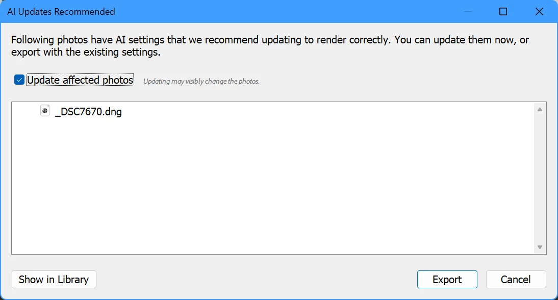

  9. Once I’m done, I go to export my photo.  I get the normal popup that tells me that some AI processing will be required in the exporting process (this is in the uploaded files below).  When I click the “Export” button, I get the error (shown in the two other uploaded images below).

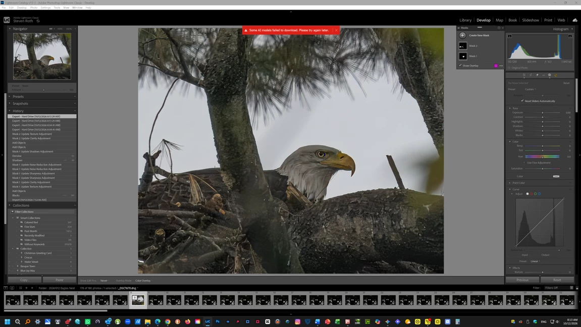

    Oct 22, 2026 1:58 PM UTC
    An update:  This problem persists with almost every export I perform.
    It DOES NOT require my using Topaz for denoising.  For the enclosed screen capture, I did use LrC’s builtin denoising capability.
    During the export, LrC tells me there will be some AI processing and when I tell it to go ahead, I ALWAYS get this error message.
    This has been going on for weeks now.
    Is there someone out there, or in the Lightroom development team, who can solve this problem, give me a workaround or fix it???
