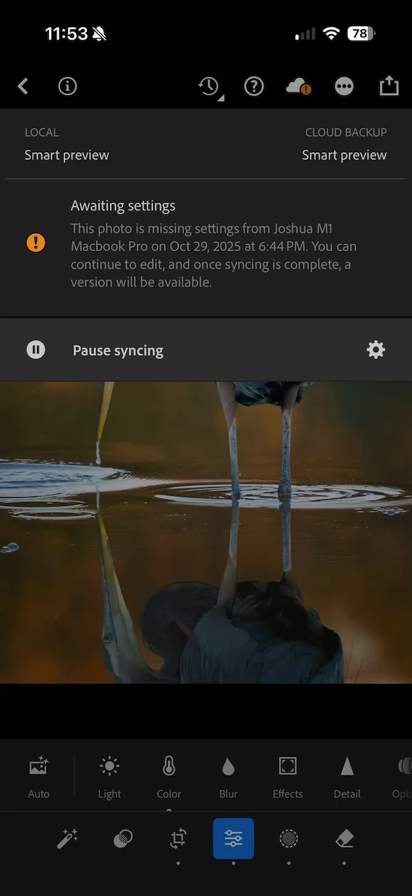

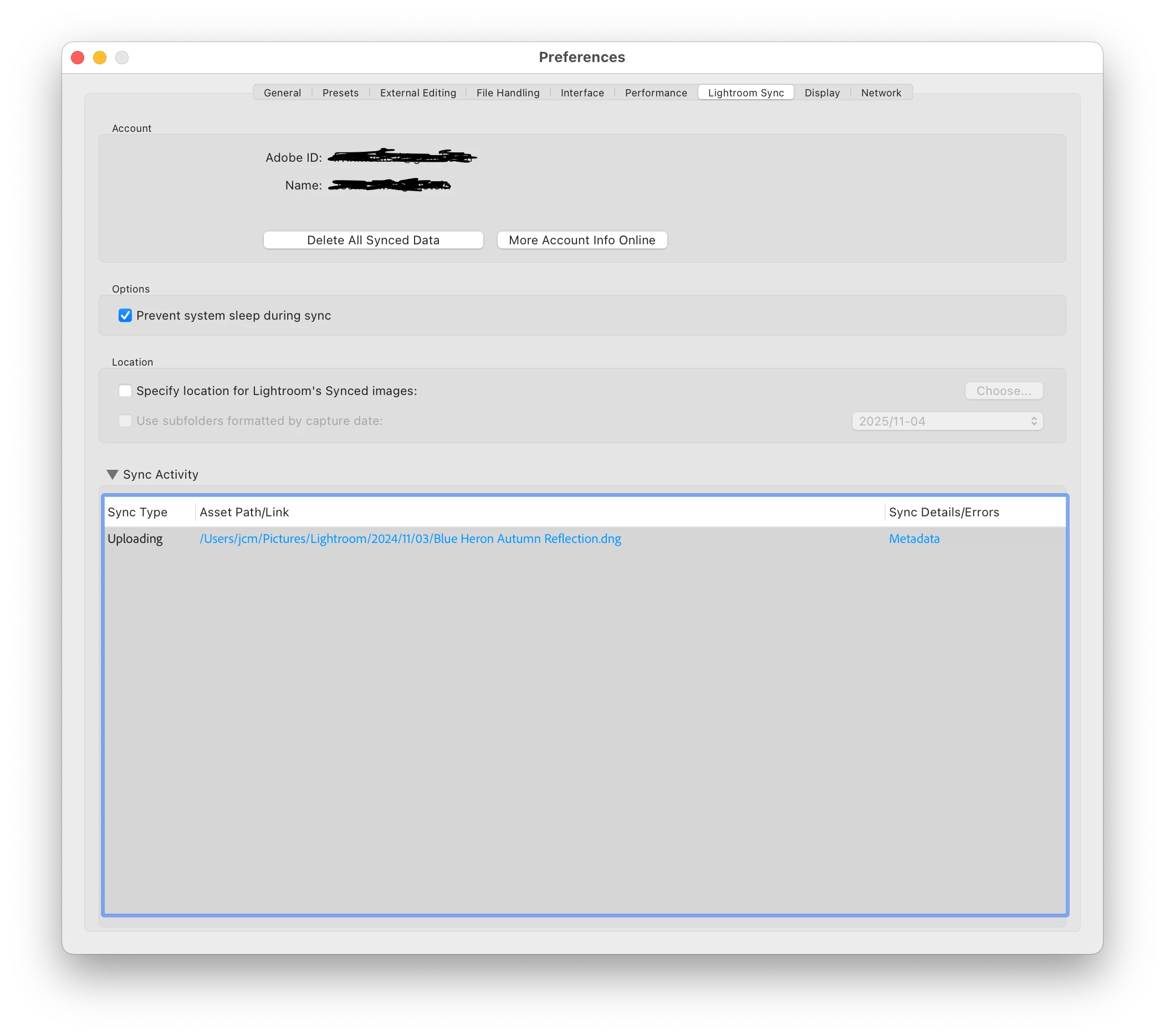

I have several collections set to sync on LrC. All additional photos I add and edits to existing sync'd photos transfer between LrC desktop and the Lr Mobile app. Except one photo. This photo has been syncing for over 6 months across several updates of LrC desktop and the mobile app. I'm including the sync error messsage from my iPhone Lr Mobile app and the sync screen in Preferences on LrC desktop.
I also did "Rebuild Sync Data" which I know newer versions of LrC now recommend you do NOT do but that has previously solved sync issues in the past. I also made minor edits to the photo on both LrC desktop and Lr Mobile as that has often "kick started" the sync process to work when photo syncing wasn't working in previous versions of LrC over the years. Neither has impacted this issue in any way that I can see.
Why is this one photo not syncing and how to fix it?

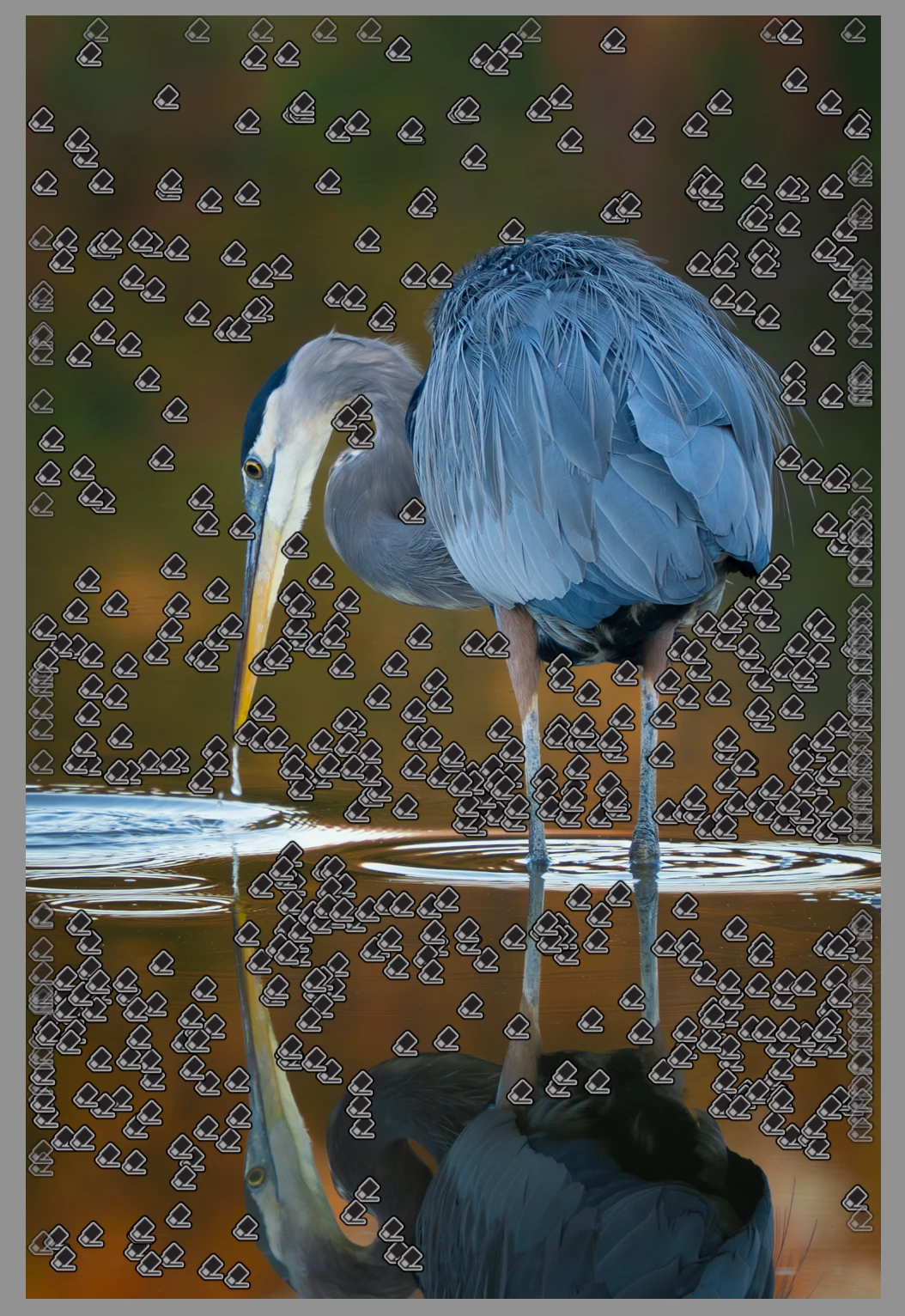

I am wondering if the number of edits I've made to this file may have anything to do with this problem. Attached is the file when I in Develop with the Remove tool active and showing all the specks I have removed from the water, along with a clear image of the edited version. This was an autumn photo and there were many tiny (but visible enough to be distracting in various ways) elements in the water (which is everything other than the heron). It's a bit unusual to have that level of debris in the water at the place I made this photo and just chose to clean it up. As you can see, there's a LOT of specks that I removed. I like how the photo turned out, but it took quite some time to do and once you clean up one section of the photo, it sort of commits you to the whole thing 🙂 Otherwise, it looks weird to have a very clean area and then the rest with specks. For clarity, I'm not interested in anyone's feedback on my editing choices. But, the fact is that in the end, there's a lot of Remove edits.
The .dng version was previously syncing for months and months with all these same edits. It seems highly unlikely it's just a matter of waiting for the changes to sync over because there's a lot of them. There cannot be that much data in the file that stores edits that it would take months to sync it over.
But, I am wondering if there is something about the volume +/- type of edits that may be causing this photo to be in a perpetual "sync" state??

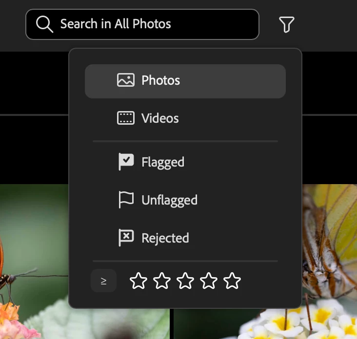

@Aleke, thanks. None of these options help, unfortunately. At the Adobe link you sent...
Solution 1: There is no "Sync Error" folder under All Photos
Solution 2: The filter icon does not list "Sync Status" as an option for filtering (see attached)
Solution 3: Says to look for "My Photos" icon which I do not have on my web version of Lightroom, only All Photos. In All photos there is a "Deleted" with a trash can icon. That folder is empty.
Any other thoughts or suggestions?

Hi @jmorg65,
You should be able to use the Sync status filter in the desktop version of Lightroom (Lr icon).
I don't think that filter is available in Lightroom Web.
