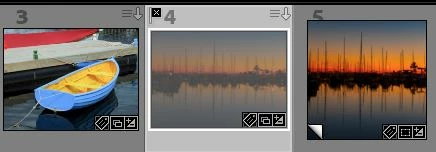

I was hastily putting together a slideshow in Lightroom Classic for a family gathering, and wanted the slideshow to include only the flagged (picked) photos. Unfortunately, I didn't see the Filter feature in the lower right corner of slideshow, but I found something else that seemed to have the desired effect. The filmstrip at the bottom shows all the pictures in the collection, but the non-flagged ones are dark grey and can't be selected.
Bur I can't remember what I did to get this and don't know how to clear it so that all photos are selectable in Slideshow. I have tried reproducing what I did with a different collection without success, and I can't find this mentioned in the documentation anywhere. Does anyone know what I did and how to clear it?

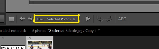

Press T to activate the Toolbar (just above Filmstrip). On there is a "Use:" dropdown menu which can be set to include All images currently showing in the Filmstrip / only those Selected / only those Flagged.
If set to "Selected Photos", as you select or deselect photos they brighten or dim (denoting IN or OUT of the slideshow).
You can see the number of slides react too, at the right hand end of this same Toolbar.
When set to  "Flagged Photos", it is this that puts each image IN or OUT of the slideshow. The thumbnail shows bright or dim accordingly. The Slideshow module is now paying no attention to its selected / unselected status.

@richardplondon  You hit the correct answer!  I had been playing around with the Filter options on the Filmstrip and never thinking about the "Use:  " options in the Tool bar.  Just as you say- if you choose "Flagged" the unflagged photos on the filmstrip fade totally (Borders and image).
Thanks.

By "Dark Grey" are you referring to the border around images, or are the filmstrip thumbnail images greyed out?
Greyed out images usually suggests they have been flagged with the 'Reject' flag [X].
Dark Grey Borders may indicate- Stacked images or Virtual Copies.
IME If I set the lower-right options to "Filter Off" I can use all images on the filmstrip regardless of flag status.
With the errant SS Collection in view -Post a screen-clip of your full screen including the FilmStrip- It might give some clues.

THanks for your reply, Rob. I have attached a screenshot. As you can see, I have filters off, but it's acting as though the other pictures were rejected, but (as I can see when selecting the Library), they aren't rejected.
