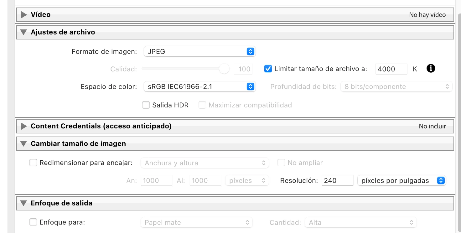

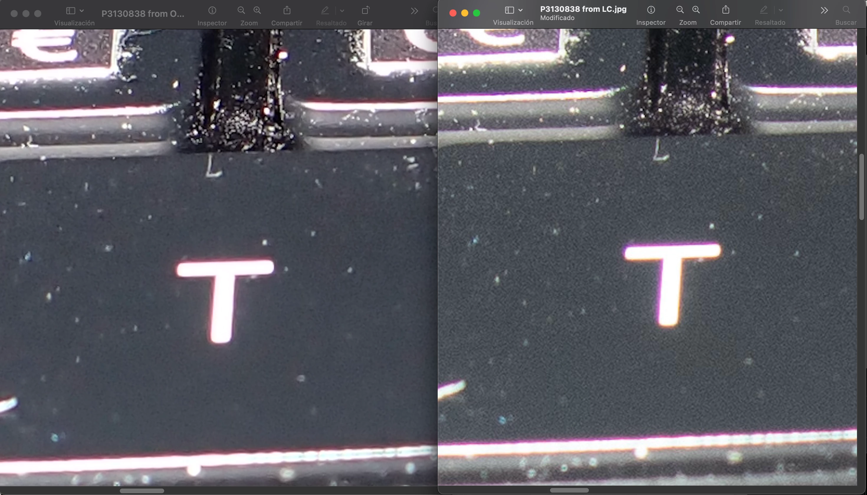

Hi, please find attached the requested files that I could upload. The jpg from OM, the jpg from LC, a printscreen with the settings used in the export (the system does not allow to upload neither dng, orf nor zip files) , and a printscreen comparing the two jpg files, where you can see the difference (the OM on the left, the LC on the right).
Thanks in advance for your help. Please let me know if you need any other information. If you need the files I could not upload, just let me know your mail and I will share a folder.

The jpg from OM Workspace has had noise reduction applied to it, the one from LrC appears to have no noise reduction.
I'm guessing that OMW automatically applies noise reduction based on the ISO value.
In LrC you have to apply noise reduction yourself.
I could give you further advice if you make the DNG available for download.

Yes, maybe OM applies automatically, as I did not manually. I also have to say that the same photo processed with the noise reduction AI in LC has a better result than the OM one, but it takes time 😞
I also compared the JPG coming from the export in OM Workspace and the one generated directly in the camara, and they are equal, so they may use the same alghorith.
Thanks for your help.
