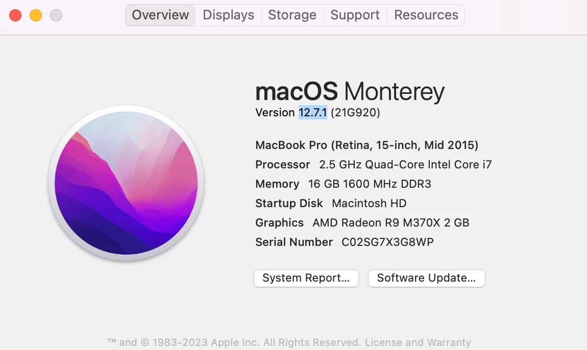

Jan 8, 2024 3:25 AM UTC
This is only happening on older Macs - I have a late edition 2015 which runs perfectly.  I tried all possible solutions mentioned re GPU & reinstalling older versions of LR.  They don't work.  I somehow came upon a solution that works for me.  I was desperate during holiday card season - I do tons of holiday card family sessions so I kept playing around.  After fully editing the image, go to CALBIBRATION.  Default is Version 6.  Chnage it to Version 4 and all issues will diappear.  If you go back and change anything, the calibration will revert to Version 6 & you will need to change to Version 4 yet again.  This is time consuming and so frustrating being that this is a service I am paying for.  We need Adobe to step in and fix this bug for the older Macs that still work great!
johnrellis
Jan 8, 2024 5:15 PM UTC
@Lisa4BOYS, the inconvenient version 4 workaround is confirmed in Adobe's pinned reply and others in this thread -- glad it's working for you.
Verify that you actually have LR 13.1 installed by doing Help > System Info. Many have reported that setting Preferences > Performance > Use Graphics Processor to Off works around the issue in LR 13.1.

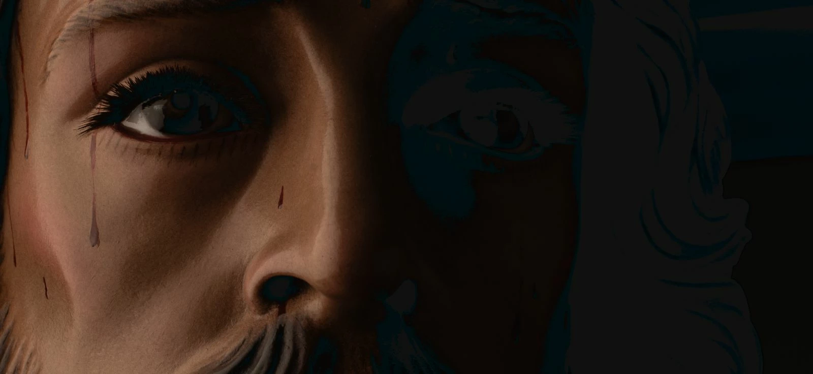

Jan 6, 2024 1:11 PM UTC
I have a MacbookPro 2015 and the latest lightroom classic, and I have a rendering problem in the dark areas of the images (only in the development module). Previous versions did not do this. I don't understand, someone help me? I have attached a picture of the problem.

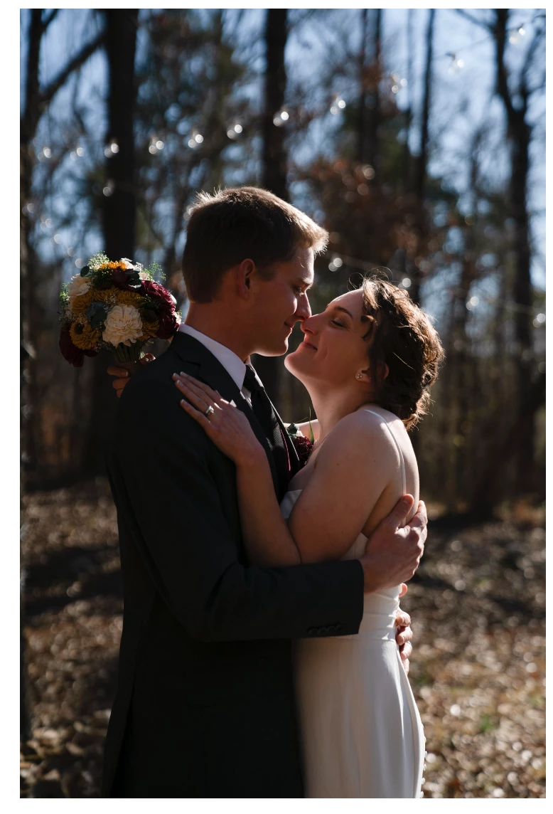

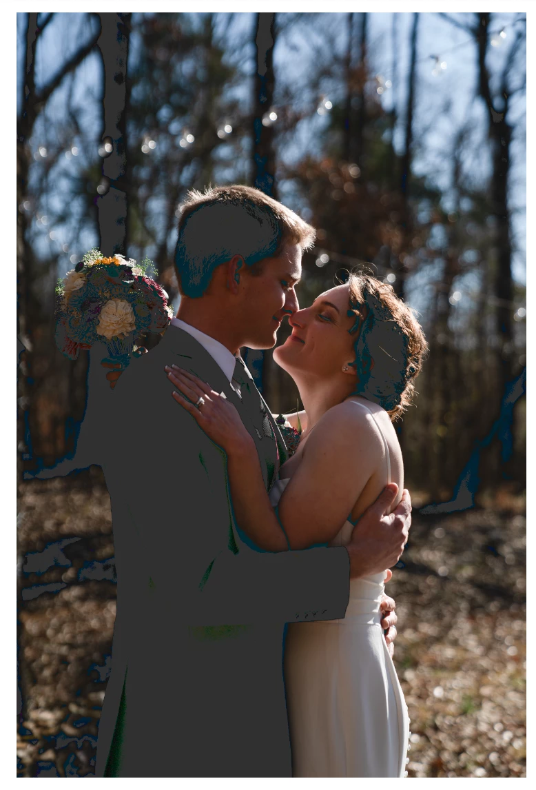

Dec 19, 2023 2:33 AM UTC
I hadn't used Lightroom classic on my computer in a while. I imported some images from a friends wedding this week and it's like the photo data is missing when I go to edit them! The shadows are completely clipped to grey with no usable pixels.
First image below is what the raw image  look like in the "Library" mode in LR - (exposed for highlights with plenty of room to boost the shadows), but then the second one (the messed up one) is what it looks like in "Develop" mode - shadows are just a flat grey blob with no pixels.
  • Images from Sony a7RII shot in raw.
  • Imported into the latest version of Lightroom Classic
  • MacOS 12.7.
  • (on a 2015 pro — can't upgrade past Monterey, and I'm hoping that's not the root issue here. Photoshot gives me an error message when I open it saying I'm on an incompatible OS, but LR hasn't shown me that error.)
1
GoldingD
Dec 19, 2023 4:20 AM UTC
A screen shot of your develop module, complete with history panel, the  histogram and at least the Basic Panel are viewable would be better. Oh and make sure that in the filmstrip or in the loupe view that the file name is shown.

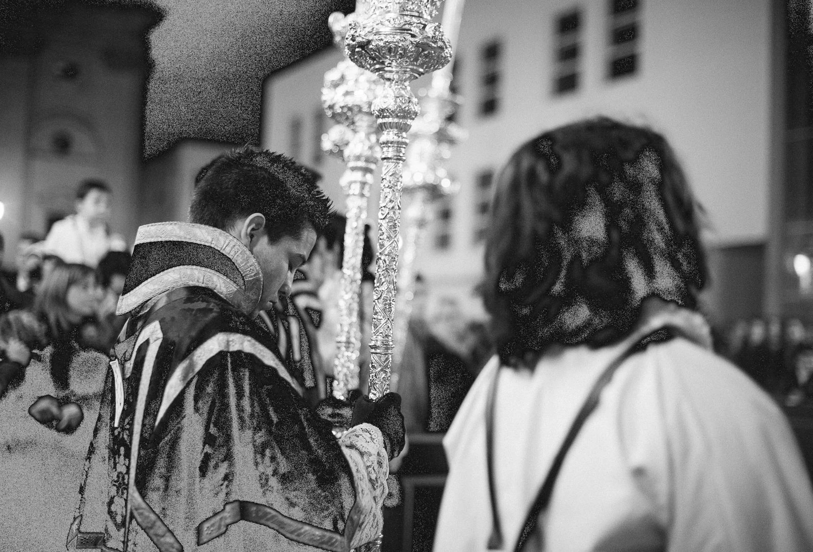

Dec 15, 2023 2:31 AM UTC
In the past month or so all the photos I export from Lightroom have had these blotchy portions in the darkest shadows in the image. Help!! I love editing my photos with deep shadows, so this is killing me.
They don't look like this when I view them in LR, only when exported. I've turned the graphics processor off, and that hasn't helped.
Rikk Flohr-Retired
Adobe Employee
Dec 15, 2023 1:32 PM UTC
Please go to Help>System Info… and provide us the exact installed version number of your software.
emmaleeh71346515
Dec 16, 2023 4:22 AM UTC
Thanks for your reply. Does this sound right?
Lightroom Classic version: 13.0.2 [ 202311290958-8ff975ea ]
johnrellis
Dec 14, 2023 6:42 PM UTC
For those using LR 13, LR 13.1 fixes the bug with disabling use of the GPU for export. So setting Preferences > Performance > Use Graphics Processor to Off should work around the problem of artifacts in exported images. Whether that results in a noticeable slowth in performance will depend on how old your Mac is and which graphics processor you have.

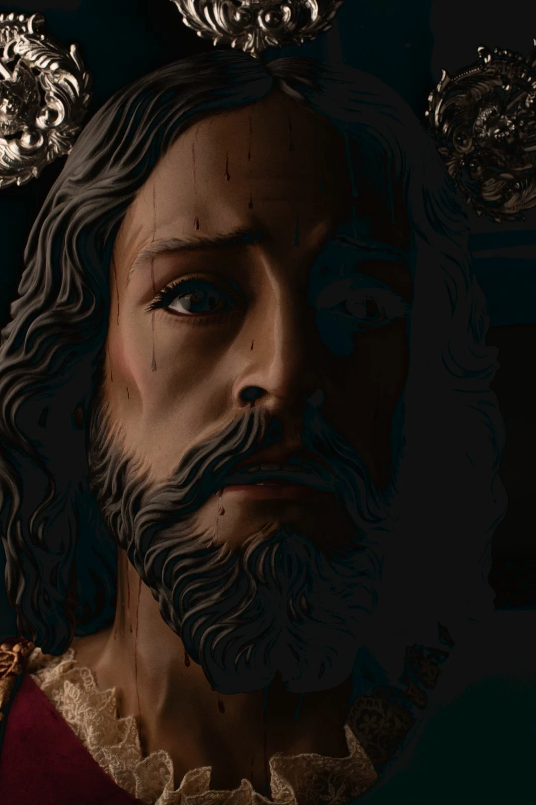

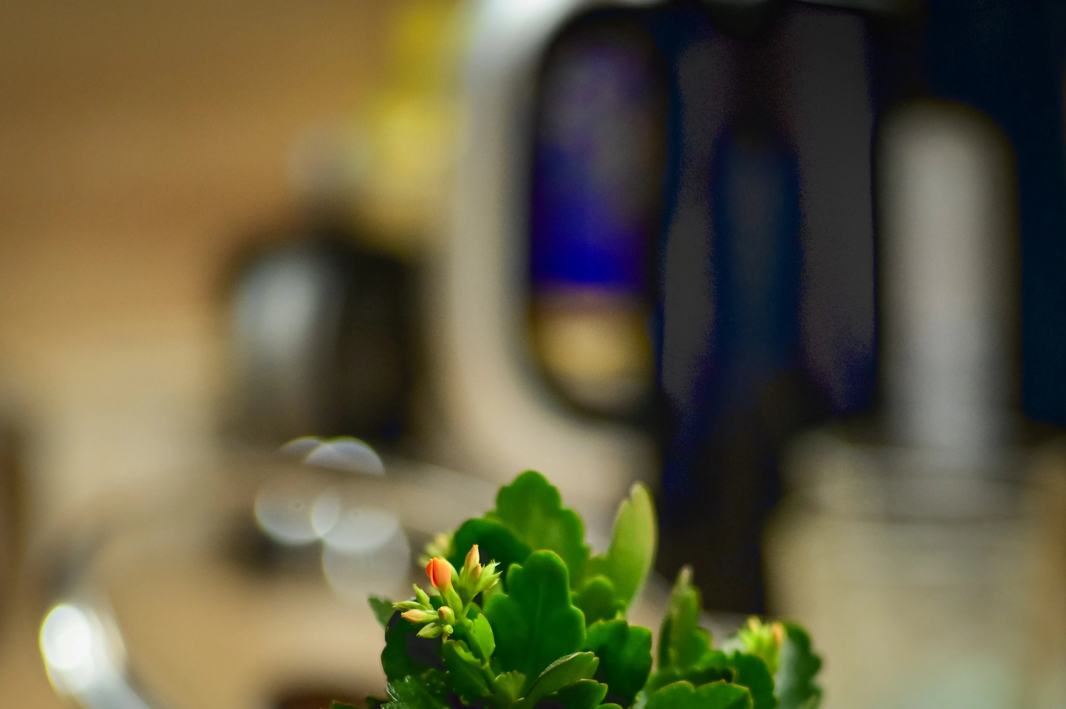

Dec 13, 2023 5:23 PM UTC
, it records them in tif with all the lights, both high and low, does anyone know how to solve this problem.
The only thing I can do is close Lightroom and reopen it but after several images the problem appears again.
I'm working on an Imac, macOS Montery Version 12.7.2
Please help, I have a lot of work editing images and this is extremely late.
I leave a sample image.
Alfred
dj_paige
Dec 13, 2023 7:13 PM UTC
I don't understand this part: "it records them in tif with all the lights, both high and low". Please explain in mroe detail. What does the photo you show have to do with this?
Also, what software are you using? Lightroom (Lr icon) or Lightroom Classic (Lrc icon)? What version NUMBER?
