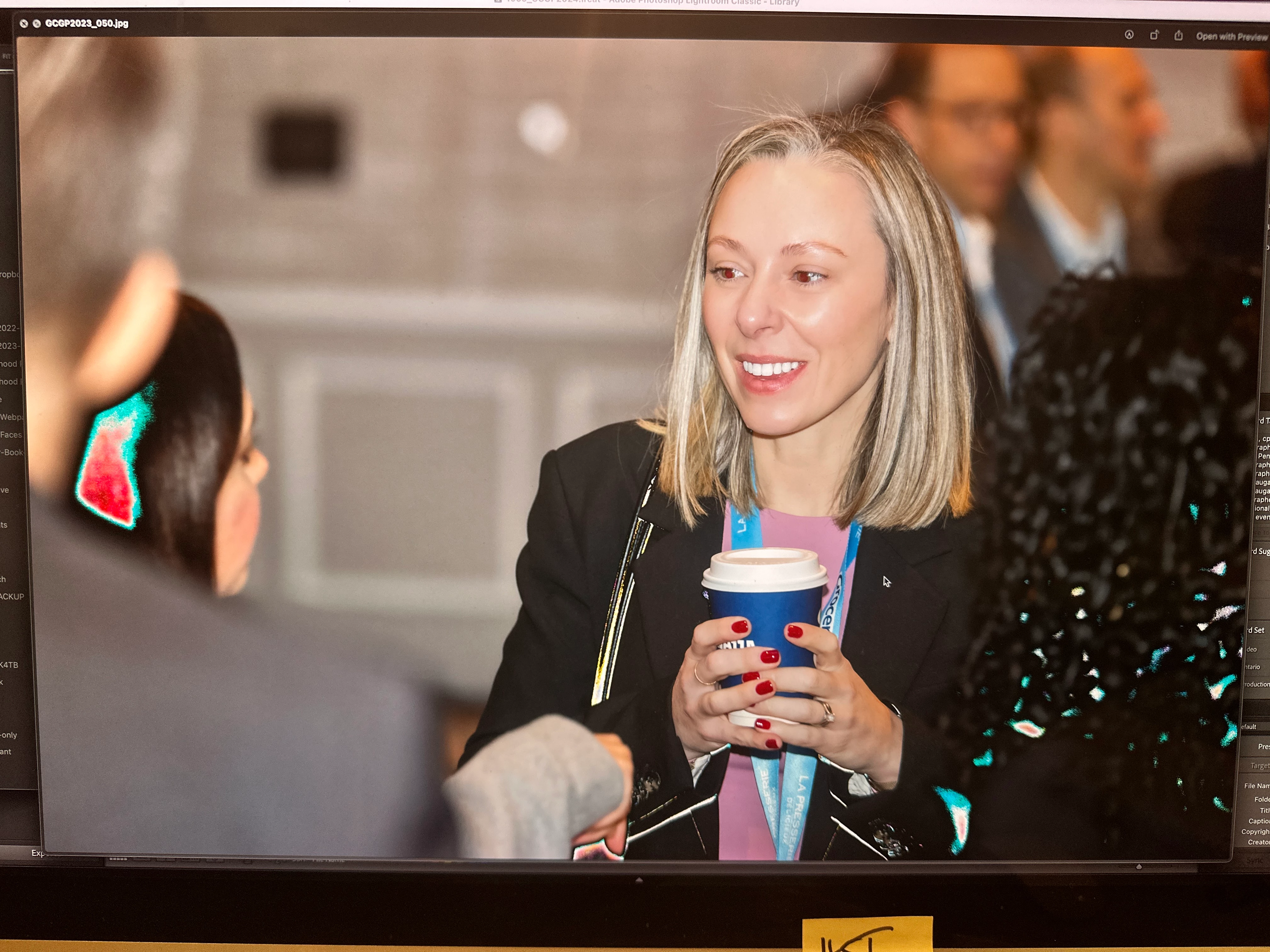

P: Colored "pixel" artifacts/subdued blacks in shadow areas (older Macs) (also visible on CR)
I updated LrC to 12.4 yesyerday. Since then a number of pixels in multiple colors appear appear quite often on the image, mostly in the areas of blacks/darks and when using Tone Curve commands. It's similar to the red/blue pixels which denoted clipping in the areas of blacks/whites, but they appear in very many different other colors. Sometimes they disappear, or decrease, after actioning the commands again, sometimes they do not. Is anybody else facing the same problem which I encounter now for the vey first time after many years of use of LrC? Thank you in advance for your advise.

During developement session I am getting in some cases rainbow color sections in pictures. Looks like area indication which are used for over lighted or underlighted. When exporting those pictures in black and white as well as colour this areas have also the same miss colour in the exported jpeg-pictures instead of correct black or white areas or coloured. The problem is, that I do not get the effect in every case
A helping hand would be great

When exporting photos I'm seeing these strange multicolored lines in different shadow areas of my photos. I've never experienced this before and have not changed anything in my export settings or camera settings. The lines are not visible within Lightroom, but only in the exported jpgs.
The strangest part is that if I try re-exporting it will get rid of the lines in some photos, but not all. It seems totally random and more like a technical glitch than a human error.

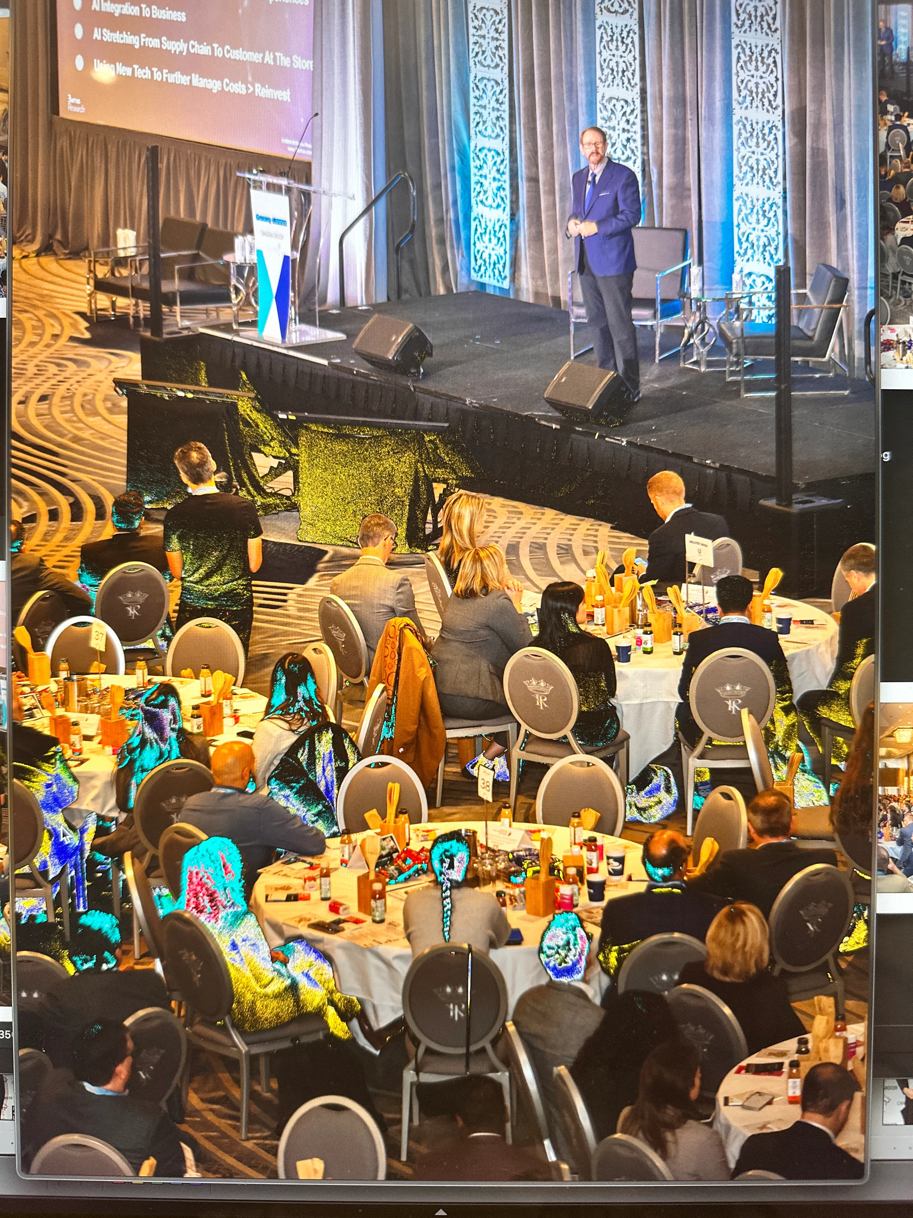

LR2024 is now adding crazy mult-color pixellation rto every Jpeg we render out (from Raw CR3 files).  Does anyone know why this is happening or how to fix it?
