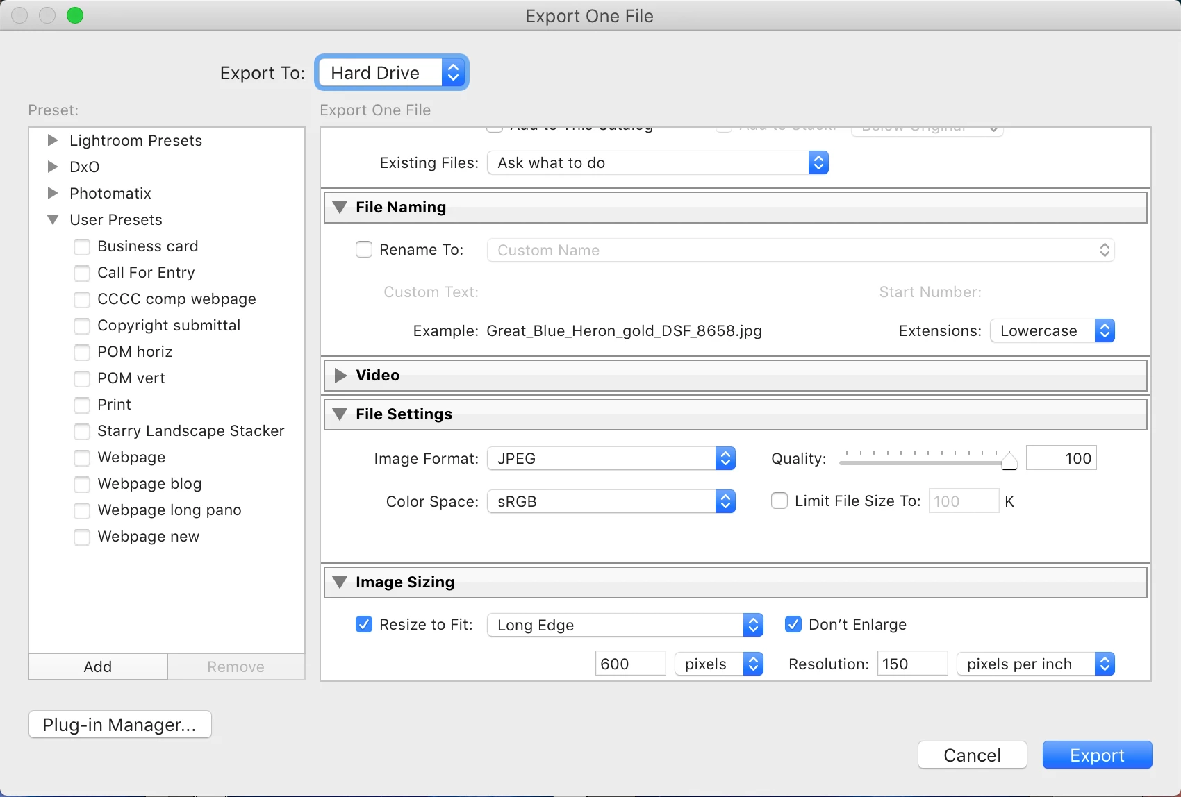

Lightroom Classic 9.0 BUG REPORT
I can't modify or even see values for export presets because it grays them out, erroneously thinking I have multiple presets checked, even when it clearly acknowleges there is only one checked ("Multiple presets: Selected 1 Preset").  What this means is, that either I must use presets without being able to see what values are being used, or if I want to modify or see the values, then I can't use presets.
I tried restarting my computer, and I even tried making a new preset in Lr 9.0, but no luck.  As soon as I check the preset, everything's grayed out.

GoldingD
November 8, 2019
And, not shown in your screenshots, down at the bottom. bellow sharpening, below watermark, a apply presets section. What is in that section?
November 8, 2019
Mac OS 10.14.6
Export window, no preset checked:
Export window, one preset checked, everything grayed out, and not displaying the preset:
You'll notice it thinks multiple presets are checked, even though it also says only one is checked in the same breath.  It then directs me to a Help page that cheerfully explains that all I have to do is uncheck them all, then check the one I want to modify ... except that doesn't work, because that's exactly what I did to begin with.  And yes, I verified that none of the other presets was checked.  Oh, and "some sections are hidden" really means "all sections are hidden".

November 7, 2019
Please show us a screen shot of what you are seeing.
