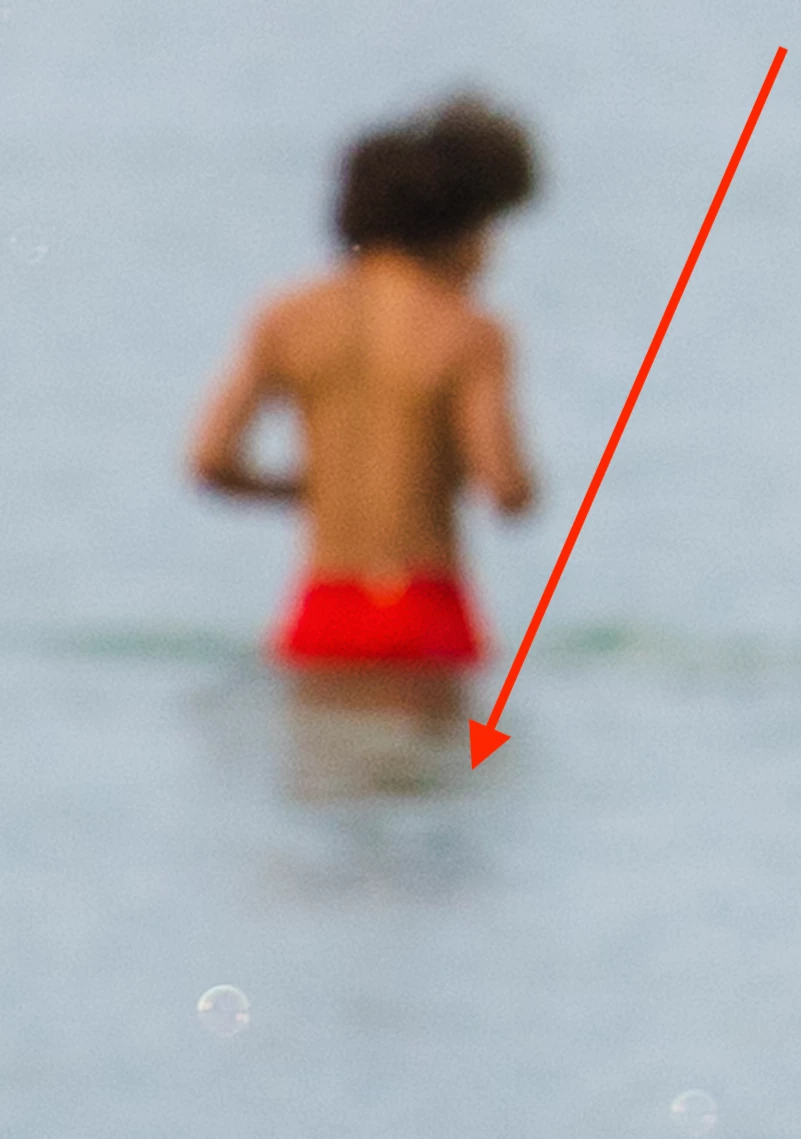

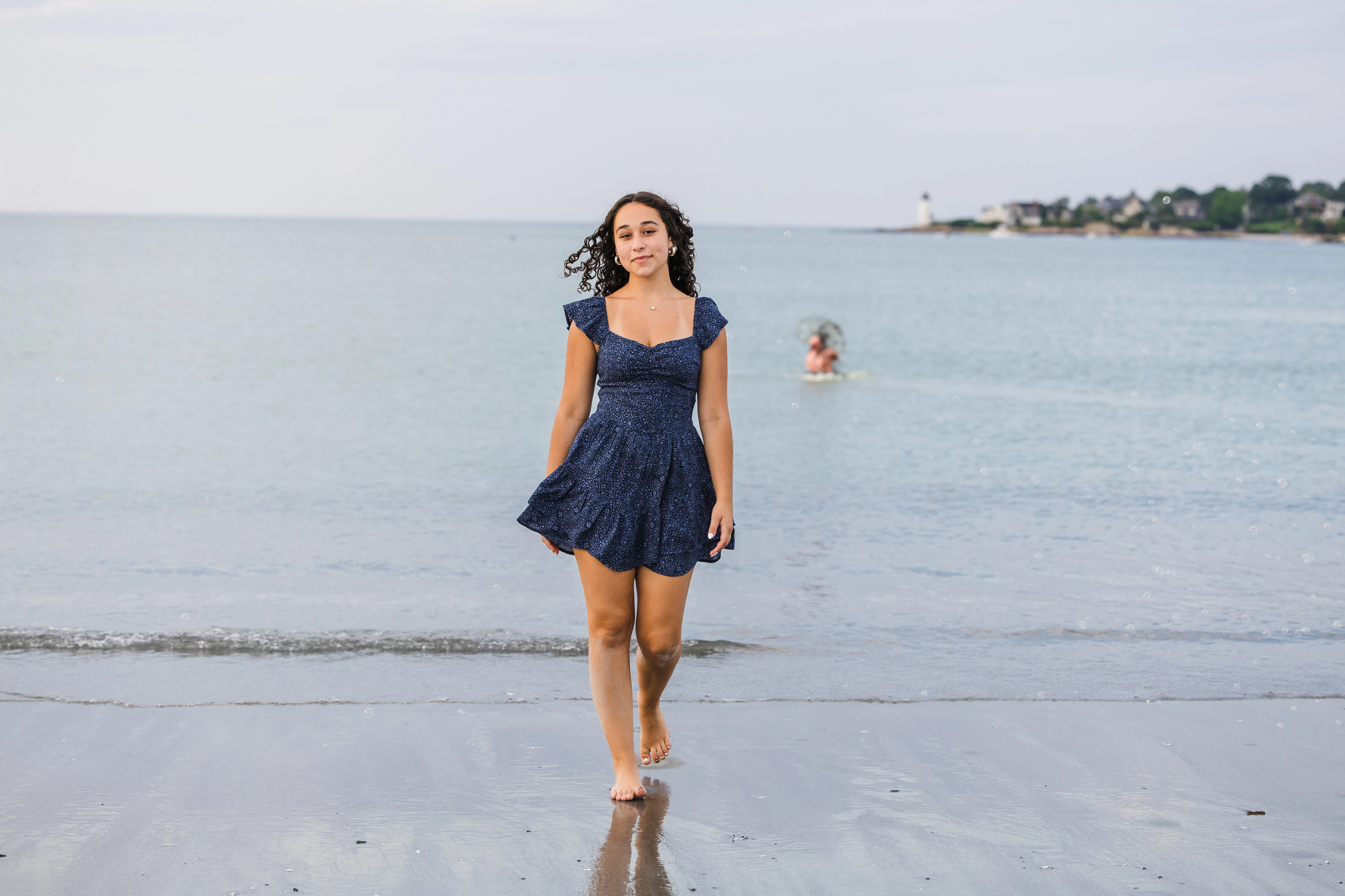

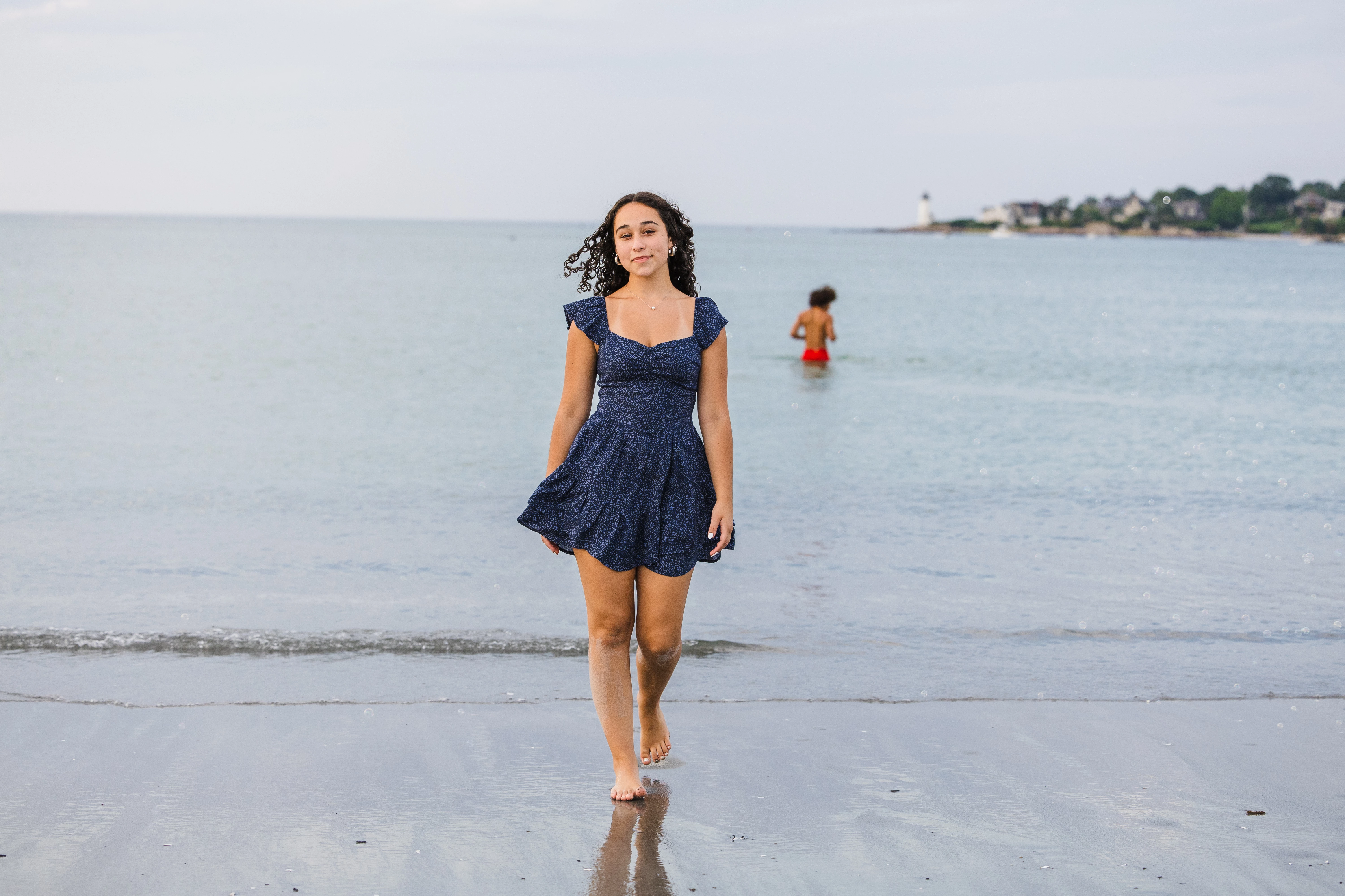

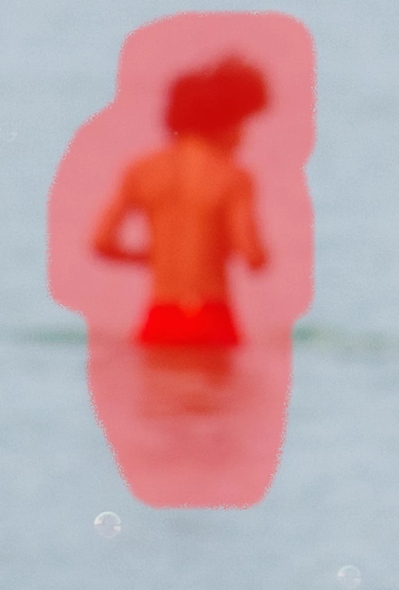

CascadeAyre
Jun 16, 2026 10:48 PM UTC
I tend to get a ghosting effect when removing objects with the generative AI. This wasn’t always the case and has started happening recently in the last couple of months.
LRC v. 15.3.1
iMac 2024
Apple M4 chip
16gb RAM
macOS 26.5.1
Before
After
johnrellis
Jun 16, 2026 11:00 PM UTC
[View this post in your web browser. It contains formatting and images that don't appear in email.]
​@CascadeAyre I tend to get a ghosting effect when removing objects with the generative AI.
Such ghosting typically happens when you apply Remove on top of an existing AI mask. Click the yellow AI Edit Status button and then Update.
CascadeAyre
Jun 17, 2026 12:12 AM UTC
This is happening with only the AI remove. No other masking/remove applied.

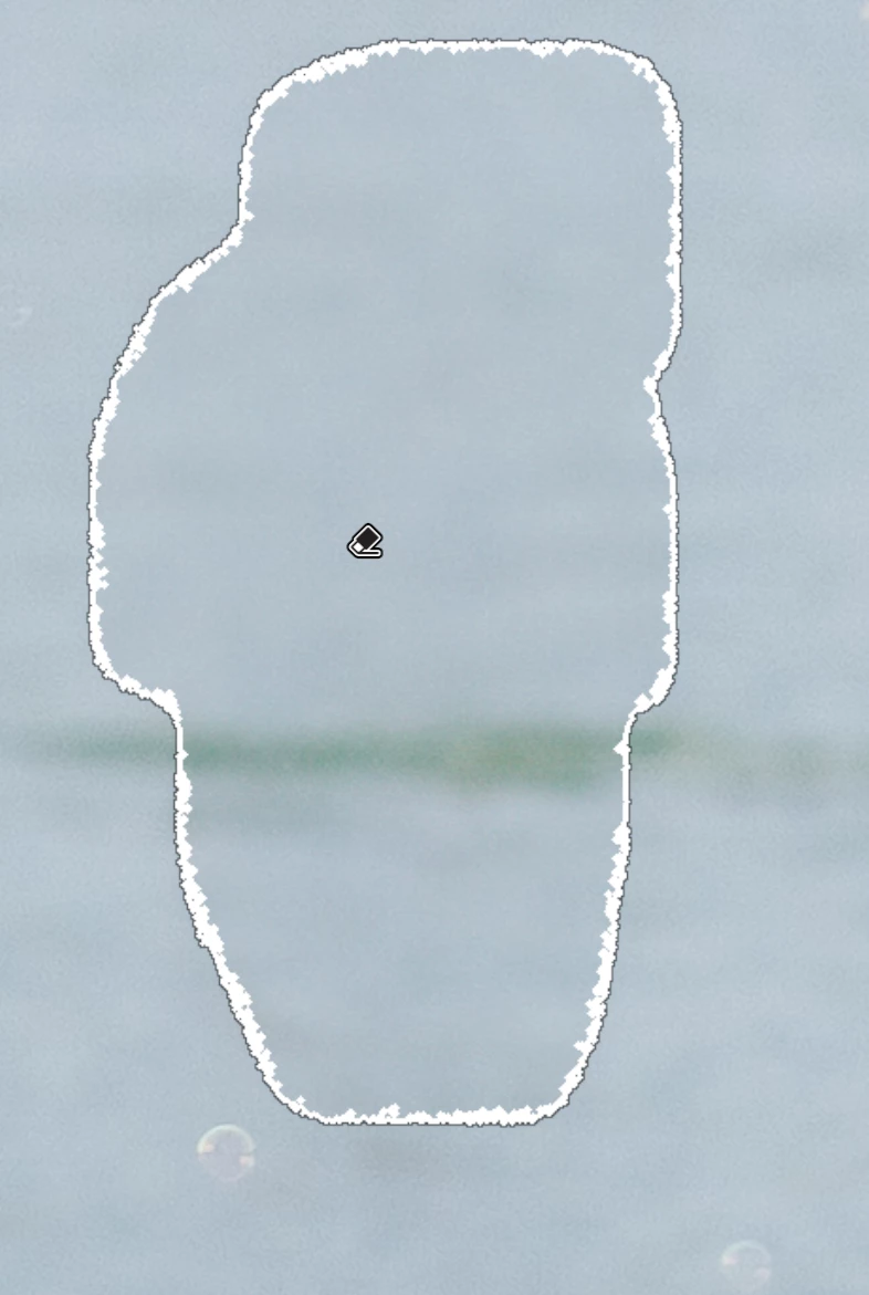

tmwphoto
Jun 16, 2026 1:05 AM UTC
Having trouble with a pretty simple remove.  It’s a tree branch, basically a long twig, against an overcast sky.  The branch has a small patch in the middle that is lighter than the rest of the branch.  For some reason the light part in the middle persists as a bright streak after using Remove, Generative Remove, or Heal options.  Even at 100% opacity it won’t go away.

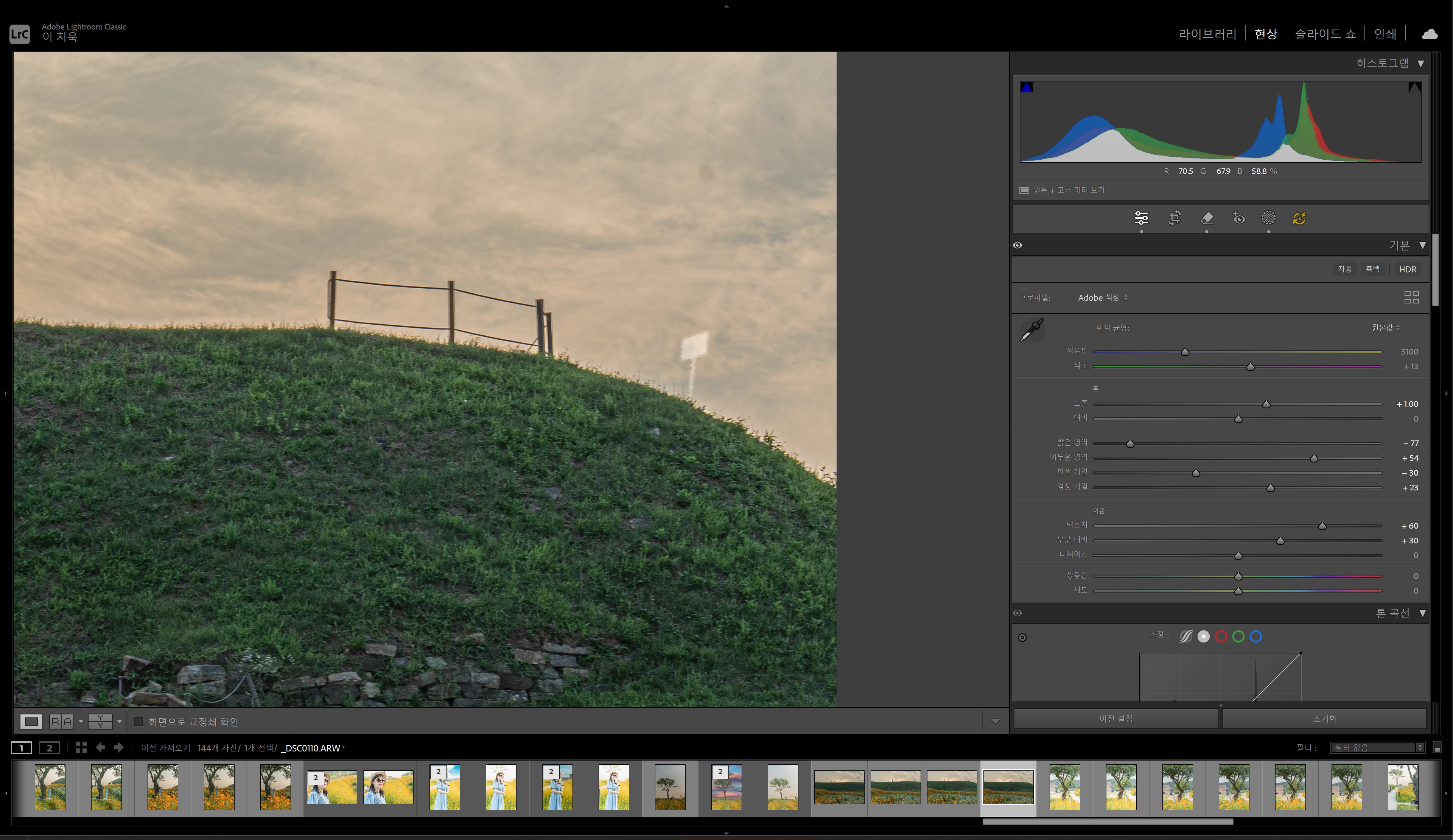

RafaelGandia
Jun 9, 2026 10:30 PM UTC
A qualidade do arquivo gerado na ferramenta de remoção generativa está horrível, não sei como resolver pesquisei e diz que tem um botao de selecionar a qualidade da geração, mas não existe botão
